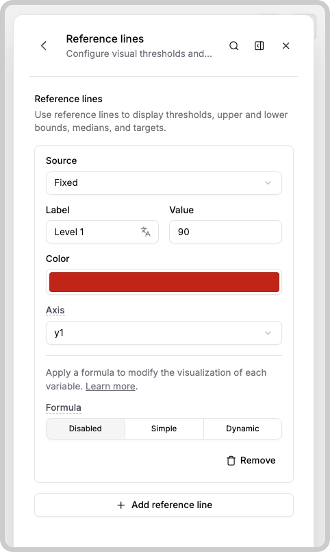

  1. Click Add Reference Line (or the equivalent button in the UI).

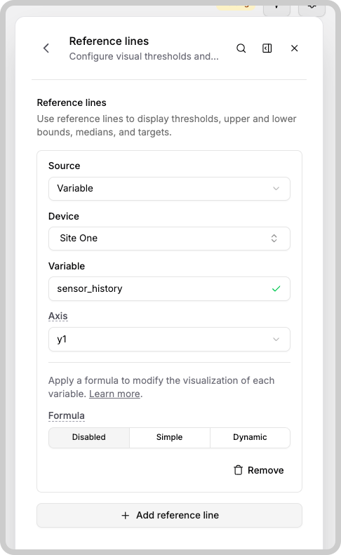

  2. Choose the source of the value:
    • Fixed: Enter a static numeric value that will be displayed as a horizontal or vertical line.
    • Variable: Select one of your device's variables; the line's value will update dynamically based on that variable.
Add Reference Line
Fixed vs Variable source​
  • When using a fixed source, you can manually set a Label and Color for the line.
  • If the source is a variable, the label and color are automatically taken from the variable's metadata. For more information about how to configure metadata, see the Metadata article.

If your chart uses multiple Y‑axes, you can associate a reference line with a specific axis by clicking the axis dropdown inside the reference line options and selecting the desired axis. This ensures the line aligns correctly with the chosen scale.
