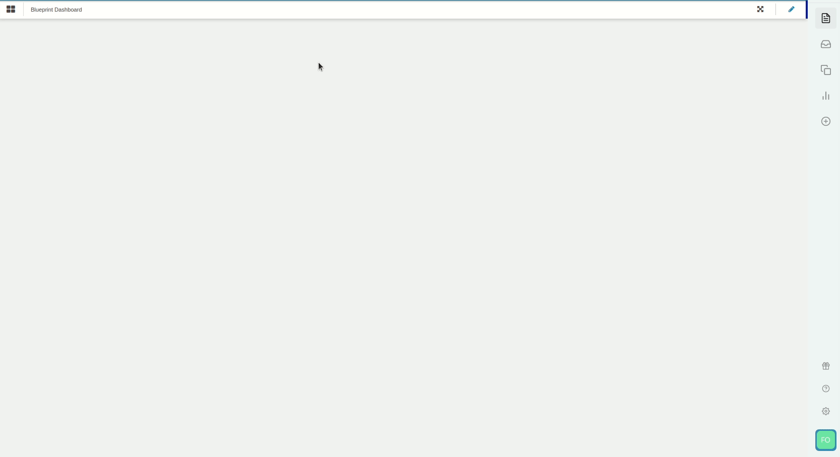

For example, this article uses the color metadata field in the following JSON payload:
"variable": "temperature",
"value": 71,
"metadata": {
"color": "red"
Image 1
