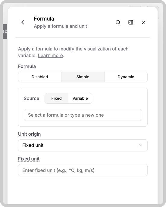

Formula configuration in widgets​
The Formula configuration is available inside most widget configuration panels. It produces a temporary, visual-only value and does not alter the stored device data.
Formula
Typical elements in the Formula panel include:
  • Formula mode: Disabled | Simple | Dynamic
  • Source: Fixed | Variable
  • The formula expression input (for example: ($VALUES$ - 273.15) * 9/5 + 32)
  • Unit origin and related unit fields
  • "Apply a formula to modify the visualization of each variable" help text and a "Learn more" link
