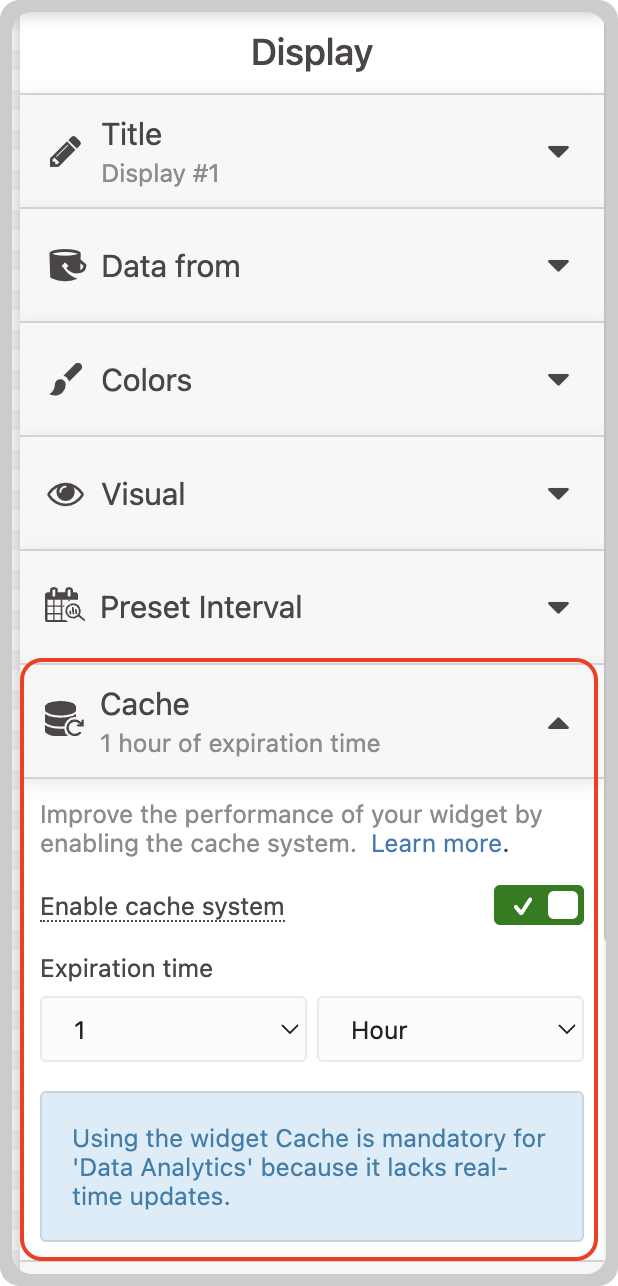

Enabling the cache system for your widget​
All widgets support the caching system; you can enable it by entering your widget in Edit mode and navigating to the Cache tab. Once enabled, you can define the expiration time, which specifies how long the cached data will be retained on our servers. You can set periods in seconds, minutes, or hours.
To enable or configure caching for a specific widget, use the widget settings in the Dashboard editor. For step‑by‑step instructions, see the Dashboard editor in your Admin. This feature is part of each widget's settings.
Image 1

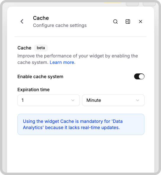

note
If you need to refresh data before the cache expires (for example, after changing the widget configuration or a Data Analytics function), you can clear the cache manually from the widget while in Edit mode. This is only available on the Admin Console.
Image 2
