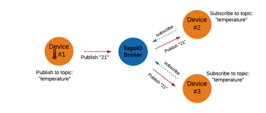

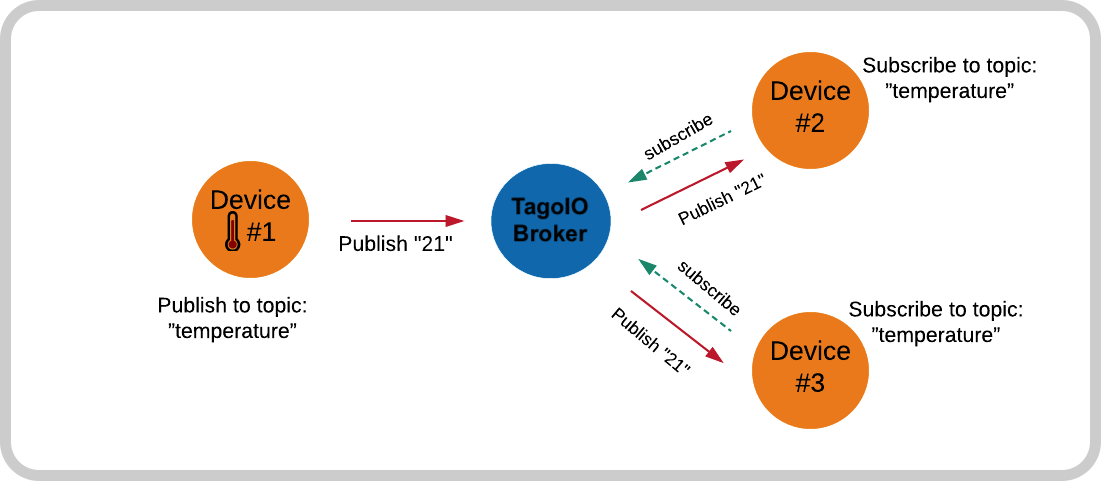

Data flow (example)
Caption: Device #1 publishes a payload (for example, "21") to the topic "temperature" on the TagoIO Broker. Devices #2 and #3 subscribe to the same topic and receive the published payloads.
TagoIO’s MQTT broker is responsible for pushing data to clients whenever new information is published on the specific topics they are subscribed to. Unlike a full‑featured MQTT implementation, it focuses mainly on ingesting sensor data into our data buckets, so some standard features such as the native Retain flag are not supported. A workaround that achieves similar functionality can be found in the article MQTT Retain on TagoIO Broker.
For example, a temperature sensor might publish a new value to the topic
temperature each time it receives an update. Devices that need to react to
these updates subscribe to that topic; when the sensor publishes, the broker
forwards the payload to all subscribed clients.

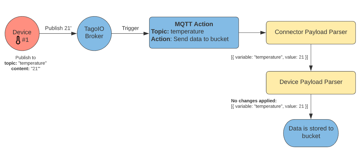

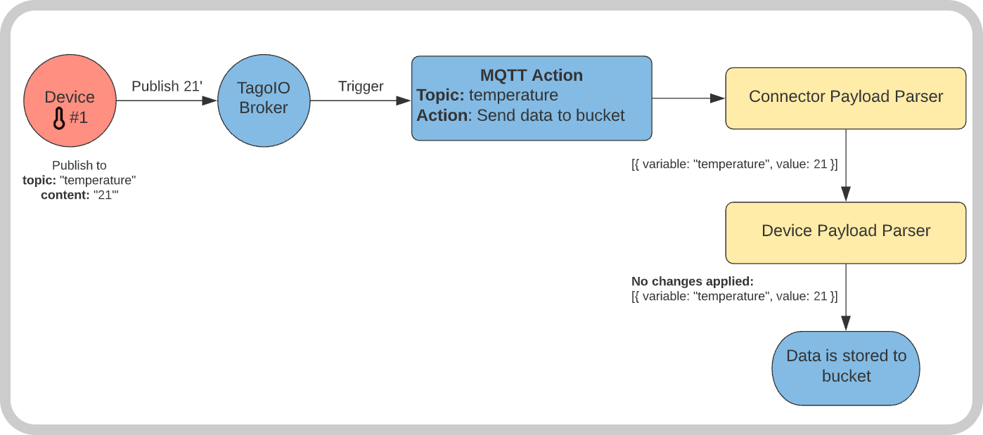

Data flow at TagoIO
When you first send data through MQTT to your device, you’ll be able to visualize the connection and message through the Live Inspector on your device. Those messages indicate that the connection is working, but nothing is being stored in your bucket yet.
From this point, you need to create an Action with trigger MQTT and type Insert to Device Bucket. Once configured, you should see the data being stored in the Live Inspector.
If you don’t send the data using the TagoIO data format, you’ll need to normalize your data and change it to the correct format. Check out our documentation on how to use a Payload Parser.
