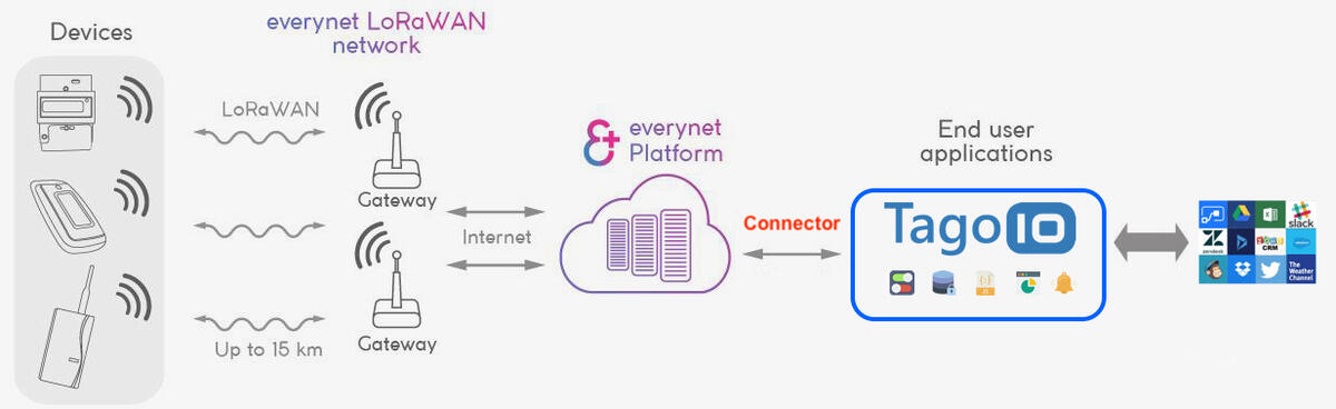

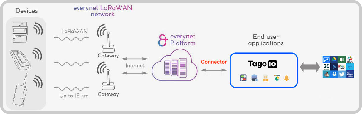

Connecting the platforms​
Everynet to TagoIO integration diagram
