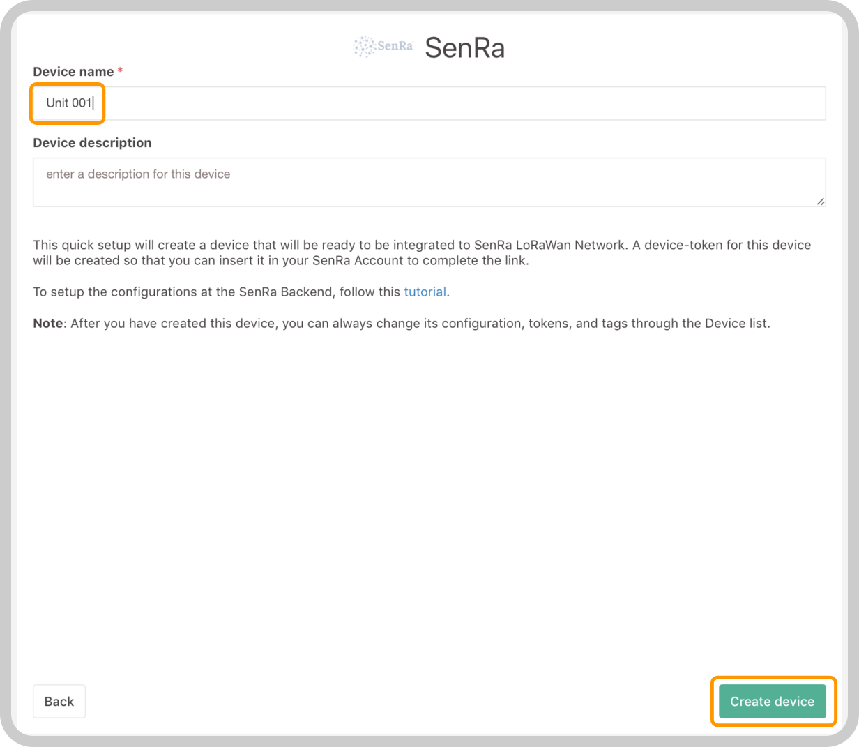

  1. Go to the devices section, search for "SenRa", and select it.
  2. Type a name for your device and click "Create device".
senra device settings
