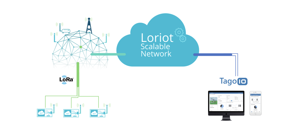

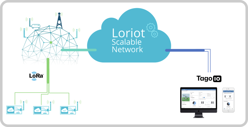

This tutorial provides a step-by-step guide to integrate Loriot LoRaWAN™ with the TagoIO Platform. By following these instructions, you will enable uplink and downlink operations, allowing data exchange between your LoRaWAN devices and the TagoIO application.
Loriot scalable network to TagoIO integration diagram
