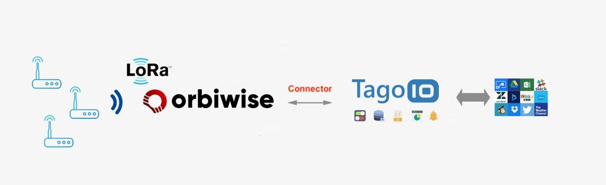

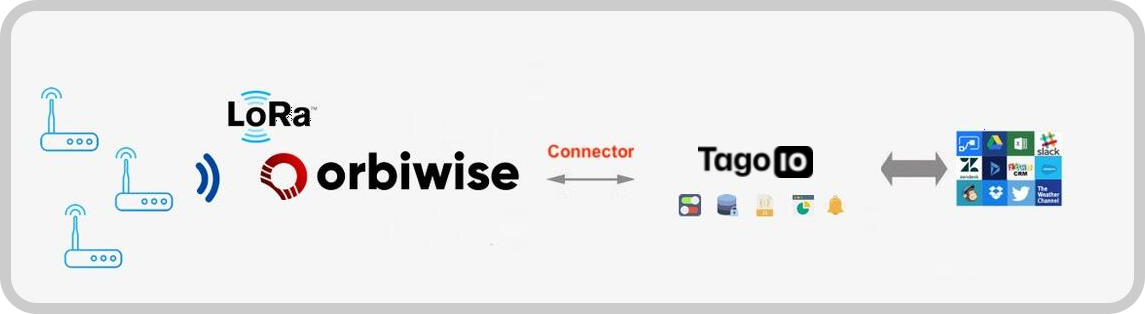

This tutorial provides a step-by-step guide to integrate Orbiwise LoRaWAN™ with the TagoIO Platform. By following these instructions, you will enable uplink and downlink operations, allowing data exchange between your LoRaWAN devices and the TagoIO application.
Orbiwise and TagoIO integration diagram

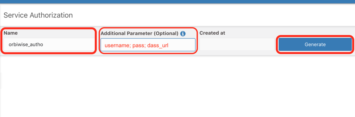

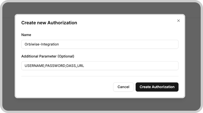

Step 1: Create Authorization in TagoIO​
  1. Access Authorizations
  2. Create a New Authorization
    1. Click the Create Authorization button.
    2. Provide a meaningful name for the authorization (e.g., Orbiwise-Integration).
    3. In the Additional Parameters section, enter your Orbiwise Username, Password and DASS URL from Step 2 in the following format:
      USERNAME;PASSWORD;DASS_URL
      Example: tagoio;iot;<your_dass_url>;
    4. Click Save.
  3. Copy the Authorization Token
    • After creation, copy the authorization token. You will need this in later steps.
Authorization token screenshot
tip
You must enter the username;password;host DASS url separated by a semicolon. Only one Authorization per application is necessary. Don't do it for each device.

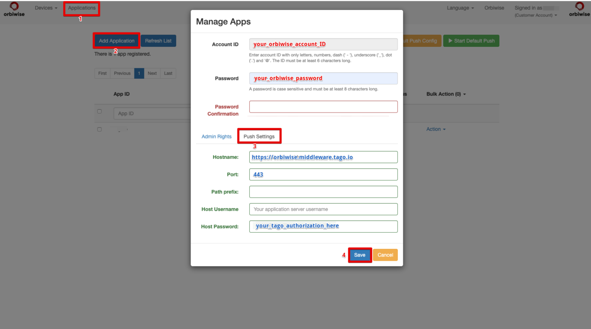

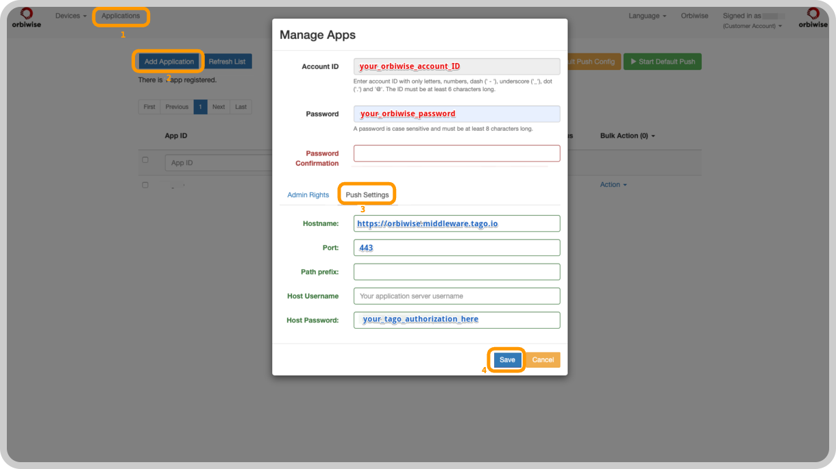

Step 2: Add Integration to Orbiwise​
  1. Go to your Orbiwise console and create a new Application.
    • Navigate through the menu: Application > Add Application > Manage Apps > Push Settings.
  2. In the Manage Apps screen, click on Push Settings and fill in the following fields:
    FieldValue
    HostnameUse the endpoint format https://orbiwise.middleware.REGION.tago.io. Replace REGION with your deployment region (e.g., us-e1, eu-w1).
    Port443
    Host PassSet its value to the authorization token you copied in Step 1.
  3. Start Push
    • Make sure that you set the status of your Application to <Start Push>.
Orbiwise backend configuration
