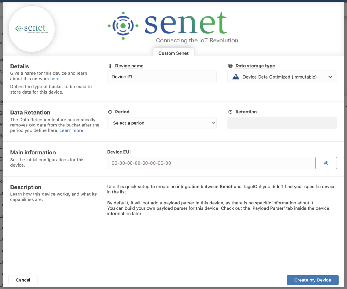

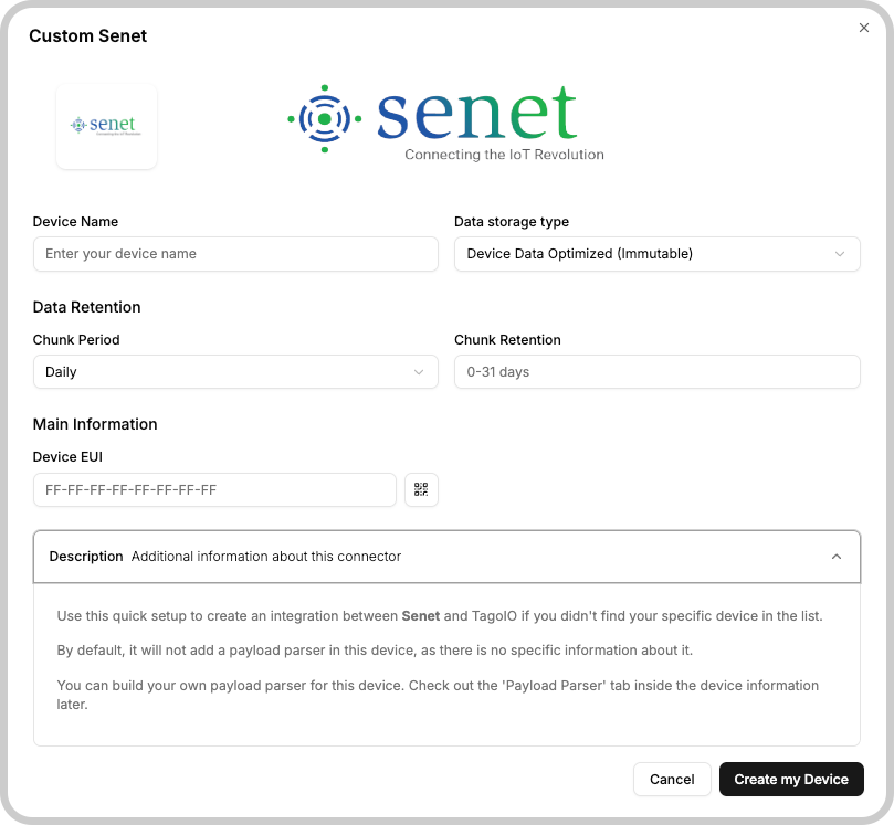

Create Device​
Type a name for your device, select a data storage type and define a Data Retention, then click on Create device.
Device creation screen

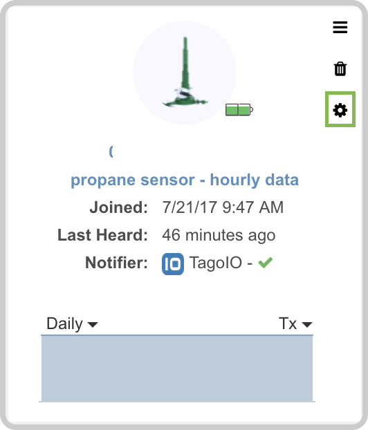

Now, log in to Senet portal and go to your devices.
Choose the device to connect to TagoIO and click on the gear icon.
Senet device settings

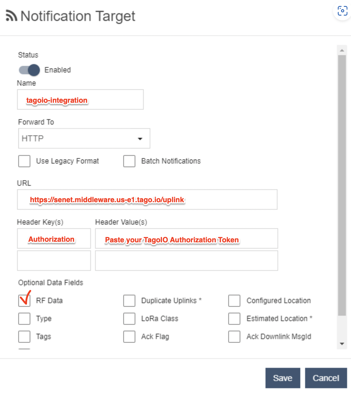

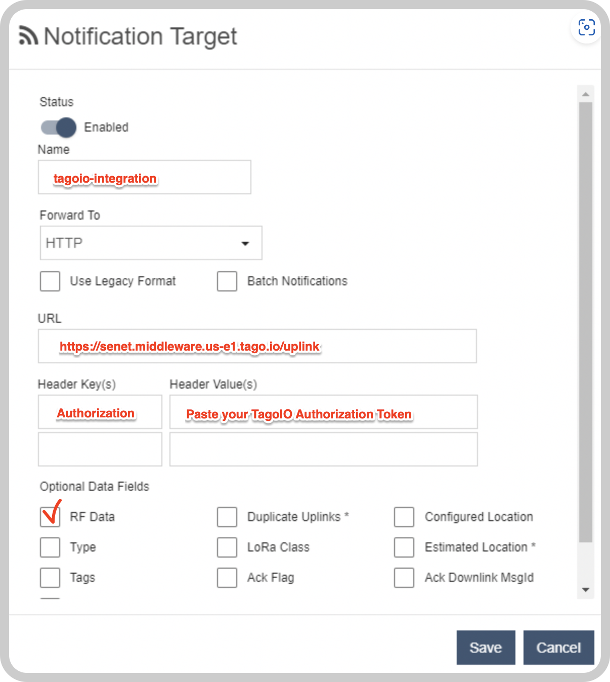

Go to "Notification Target". Make sure the status is Enabled, select HTTP in the 'forward to' field, and fill the fields accordingly:
FieldDescription
NameEnter a unique identifier (e.g., tagoio-integration).
Forward To HTTP URLUse the endpoint format https://senet.middleware.REGION.tago.io. Replace REGION with your deployment region (e.g., us-e1, eu-w1). For a list of available regions, visit TagoIO Network Integration.
HeadersAdd a header key Authorization and set its value to the authorization token you copied in Step 1.
Optional Data FieldsEnable RF Data and any other optional field you would like to receive in your device.
Notification Target configuration

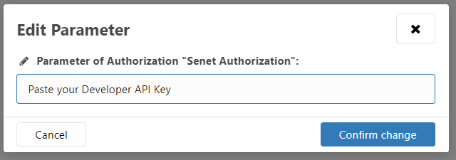

To support downlinks from TagoIO to Senet, you need an additional step.
  1. At the Senet portal, go to your Account Settings, generate a Developer API Key and copy it.
  2. Now go back to the Authorization page where you created your authorization in Step 1.
  3. Click to edit the Additional Parameters of the Authorization.
  4. Paste your Developer API Key and press Save.
Developer API Key configuration
