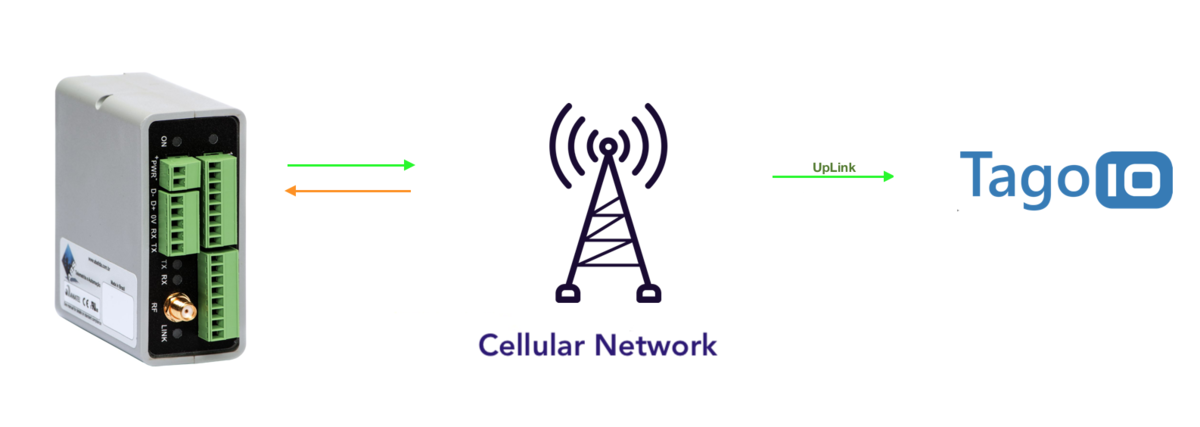

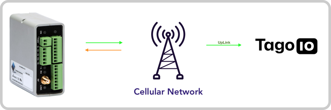

Devices from ABS Telemetry can be easily integrated with TagoIO. The integration allows uplink communication between the device and TagoIO while parsing messages to extract commands and variables in real time.
ABS Telemetry device integration diagram (device → cellular network → TagoIO)

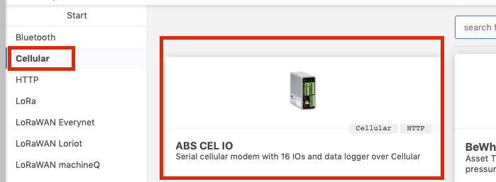

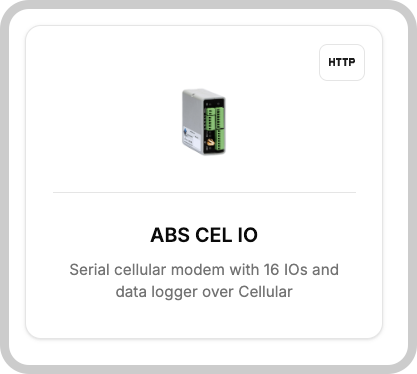

Add a device in your account at TagoIO. Go to Devices and click on 'Add Devices', filter network by 'Cellular' and pick your device from the list.
Image 2
Currently, the following device is integrated with TagoIO: ABS CEL IO
Click on 'Create Device', and you will have confirmation that the device was created.
