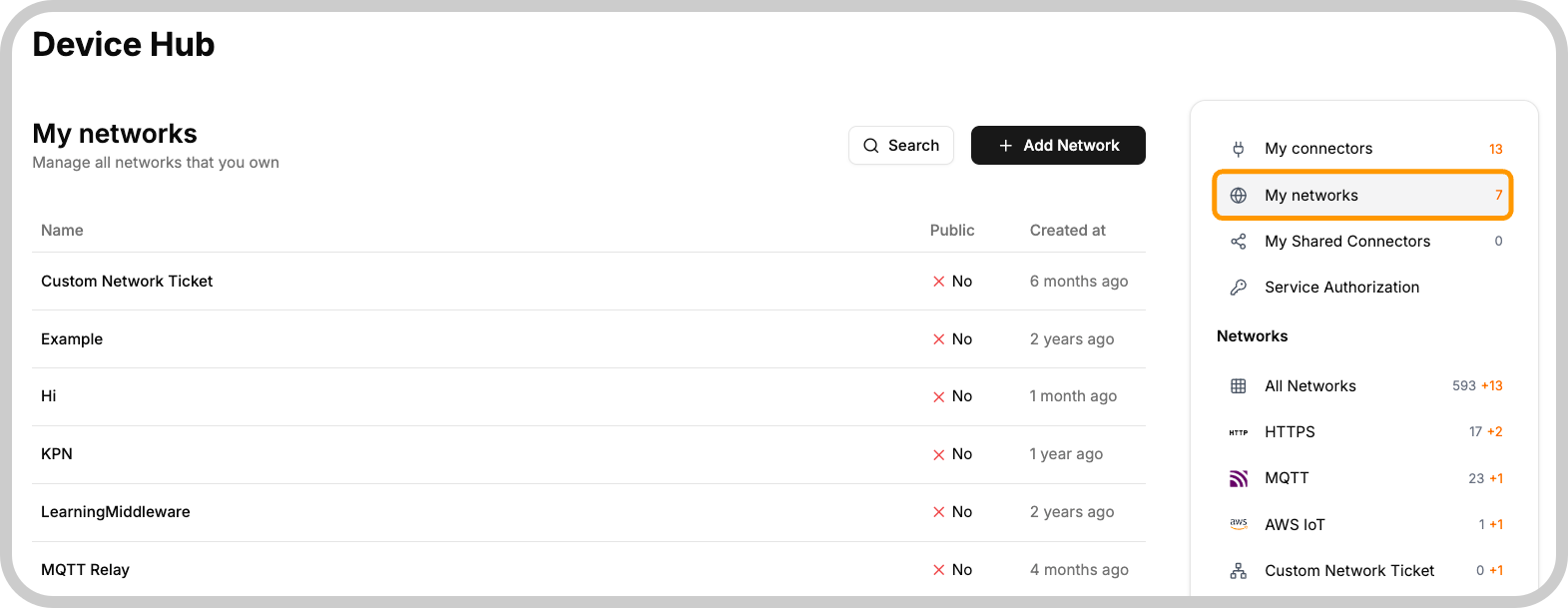

To create a new integration, go to the admin panel and click on the Integrations button in the sidebar menu. From there you can click on the "My Networks" on the menu on the right side of the page and finally click on the "Add network" button.
Create a new integration
All you'll need to add is the network's name and click on the "Create my Network" button. Now you can configure the network's parameters by clicking on the "My networks" list.

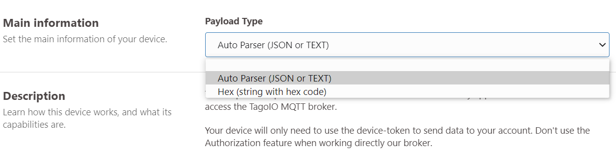

Device parameters let you set values that can later be accessed in the payload parser. They can be of type Number, Text, Dropdown, or Switch.
Example: A "Payload Type" dropdown parameter appears in the user view as shown below.
Dropdown parameter
For details on accessing these parameters in the payload parser, see the Payload parser context overview.
