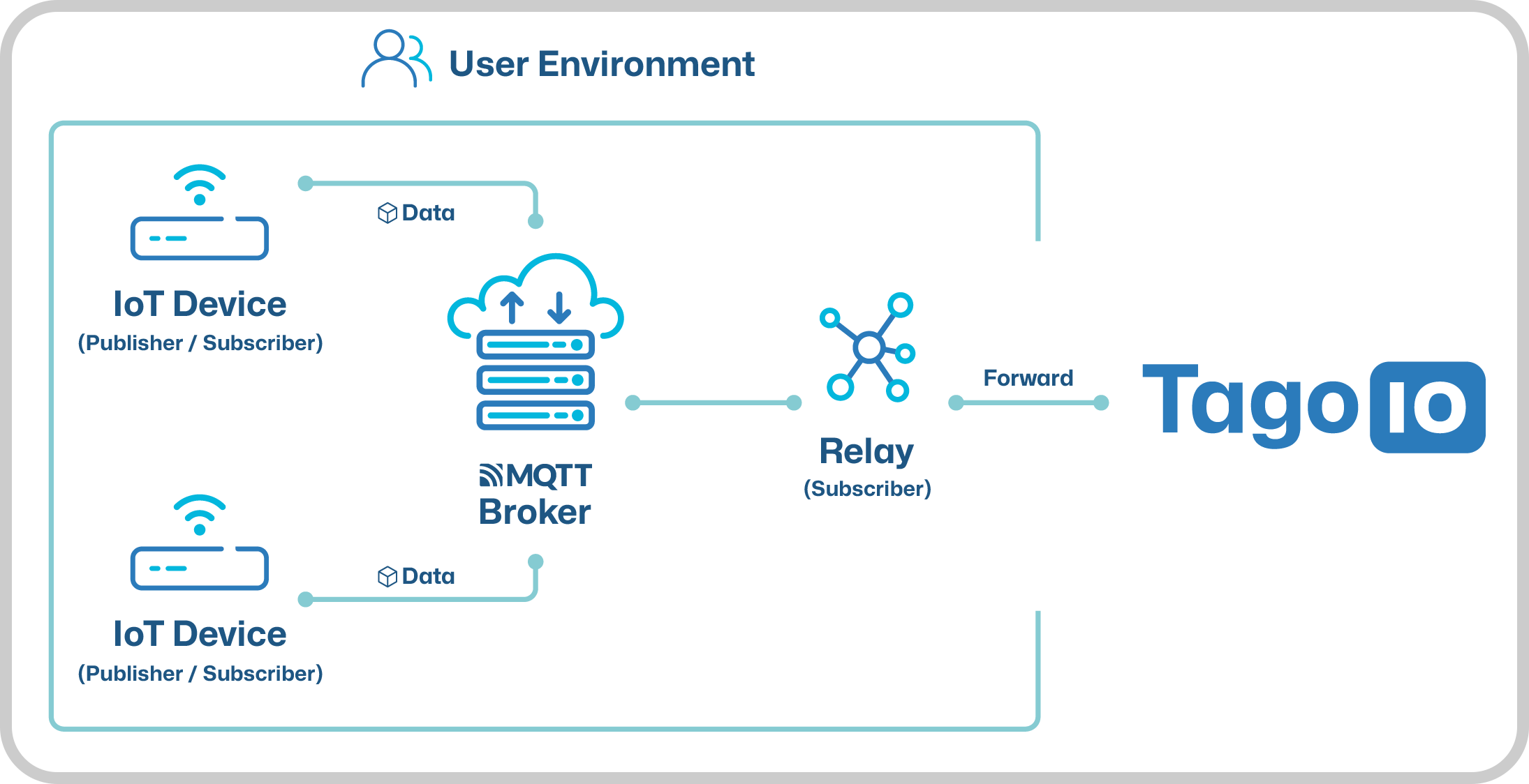

TagoIO supports MQTT connections through the MQTT Relay command-line tool. The relay acts as a bridge between your MQTT Broker and the TagoIO platform, enabling integration and reliable data flow. Developed in Rust, the TagoIO MQTT Relay is fast, open-source, and highly scalable.

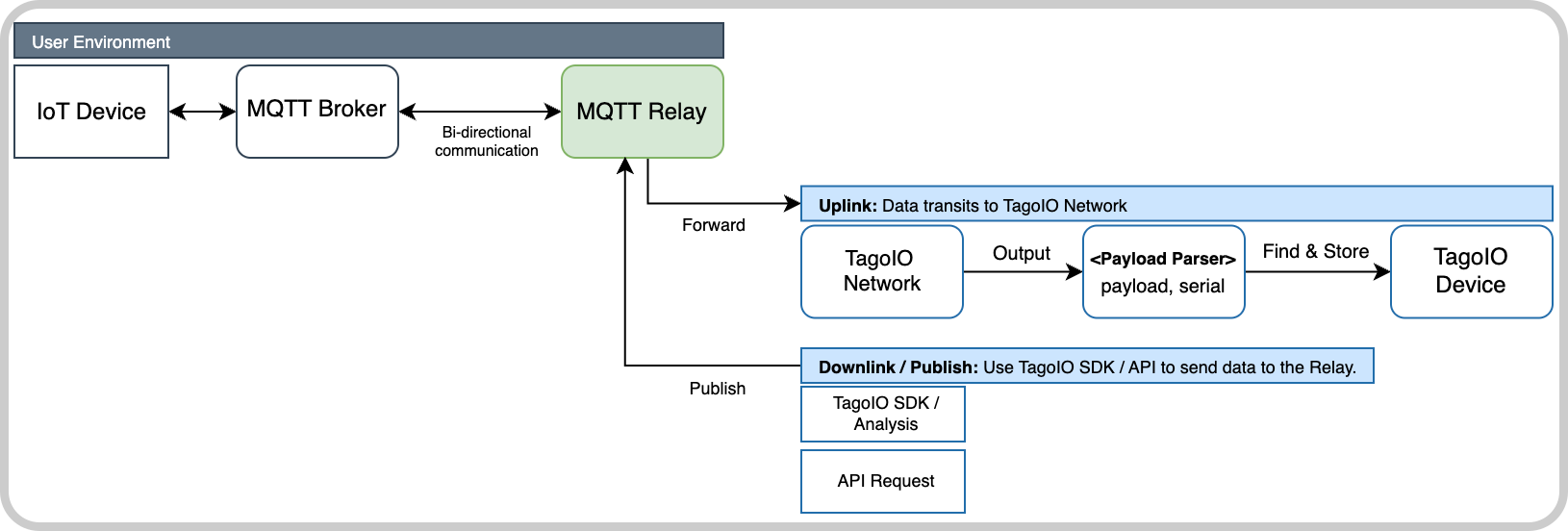

MQTT Diagram
What is TagoIO MQTT Relay?​
The relay connects to your broker on predefined topics and redirects incoming data to Devices in your Profile using an Authorization Key from your profile settings. It uses TagoIO's Integration Network and Connector to process and store the data. In addition to receiving data, the relay can also publish to topics, allowing bi-directional communication via standard TagoIO tools such as the API and SDK.
MQTT Fluxogram

How it works​
Data Flow​
  1. MQTT Broker Connection: The relay connects to your MQTT broker and subscribes to predefined topics.
  2. Data Redirection: Incoming data on these topics is forwarded to TagoIO Devices.
  3. Network Integration: The relay uses the Integration Network and Connector to process the payload.
  4. Device Identification: A Payload Parser exports a serial that TagoIO uses to store the information in the correct device within your Profile.
