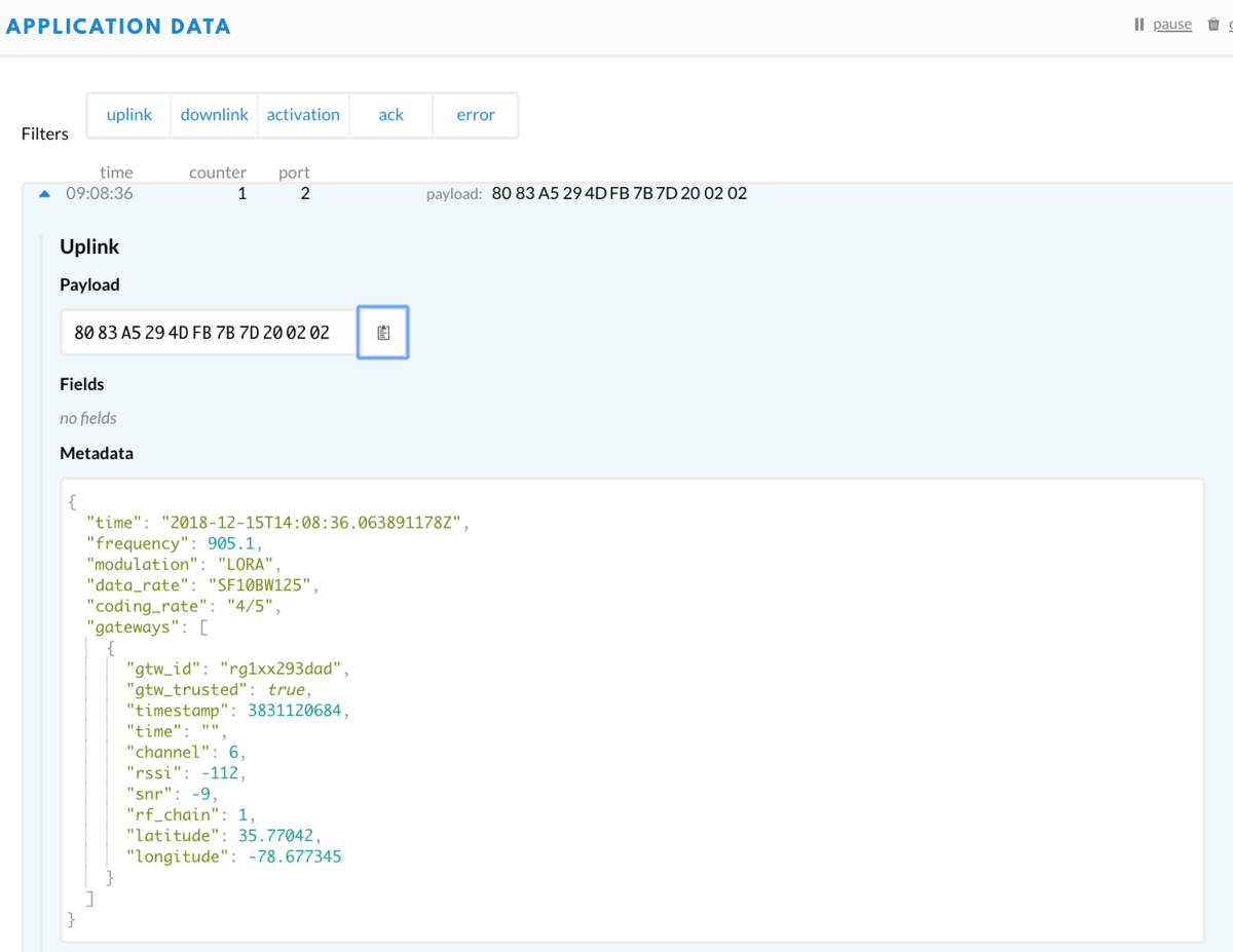

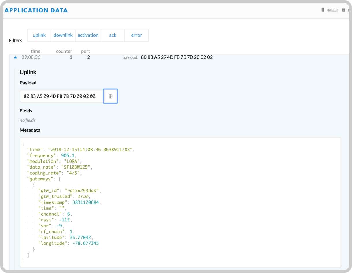

For example, if your device sends data from TTN (The Things Network), most variables, including the raw payload, will normally be created in the device's data storage. You can modify the parser to prevent storing specific fields or metadata you don't need.
A variable called location is automatically created by combining the fields latitude and longitude. Use this combined field when plotting maps.
Application Data Console screenshot
