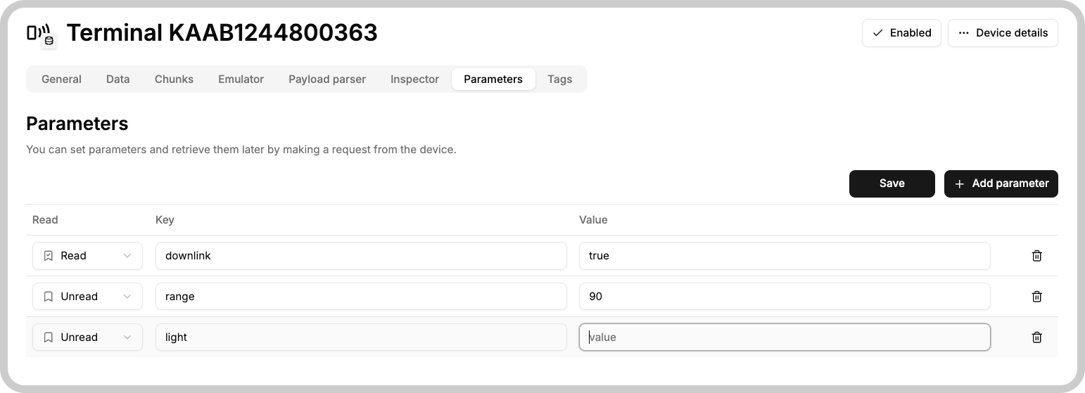

Configuration Parameters are stored on the configuration page of your device. You can access them by clicking on the Devices module in the left menu and selecting a device. You will see a tab called "Parameters", where you can add, edit, or delete parameters. You can set parameters and retrieve them later by making a request from the device.

Each Configuration Parameter has three configurable fields:
  1. Read & Unread: A boolean value (true or false) that indicates whether the parameter has been sent to the device.
  2. Key: Name of the parameter that you can use to reference it in your code or widgets.
  3. Value: The value you want to assign to your device for that parameter.
