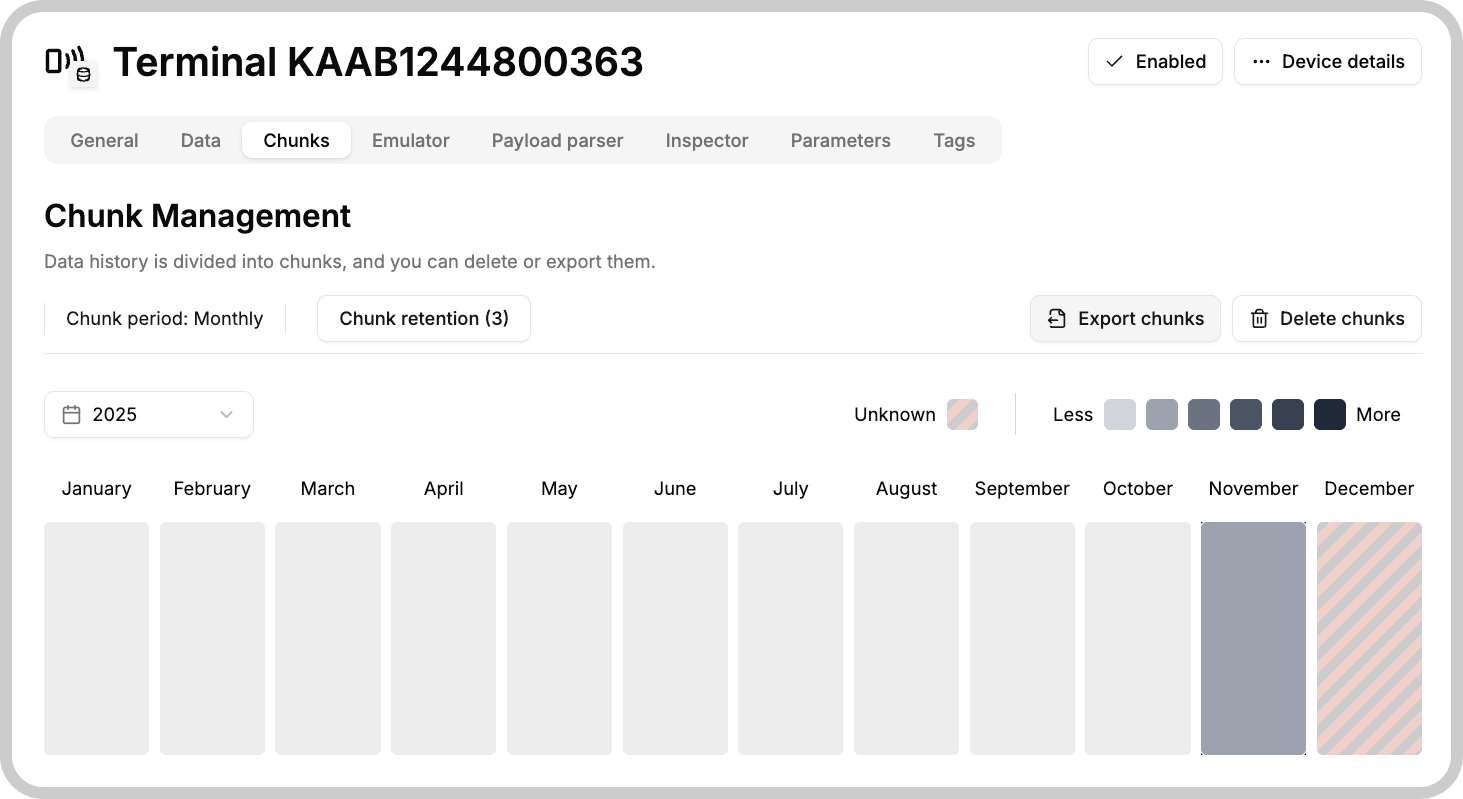

Accessing Chunk Management​
Access the Device module and select a Device Data Optimized (Immutable Device) from your list. In the device page, you will find the Chunks section, which displays a graph of your data chunks according to the period you chose when creating the device. See Immutable devices and Device for details on device types and the Device module.

Delete chunks​
You can delete chunks to optimize your data storage. This is an irreversible process, and once done there is no going back, so make sure you are certain before removing anything. Hover over the graph to check the chunk range information before deleting. All interactions with this feature are logged in the Audit Log.
