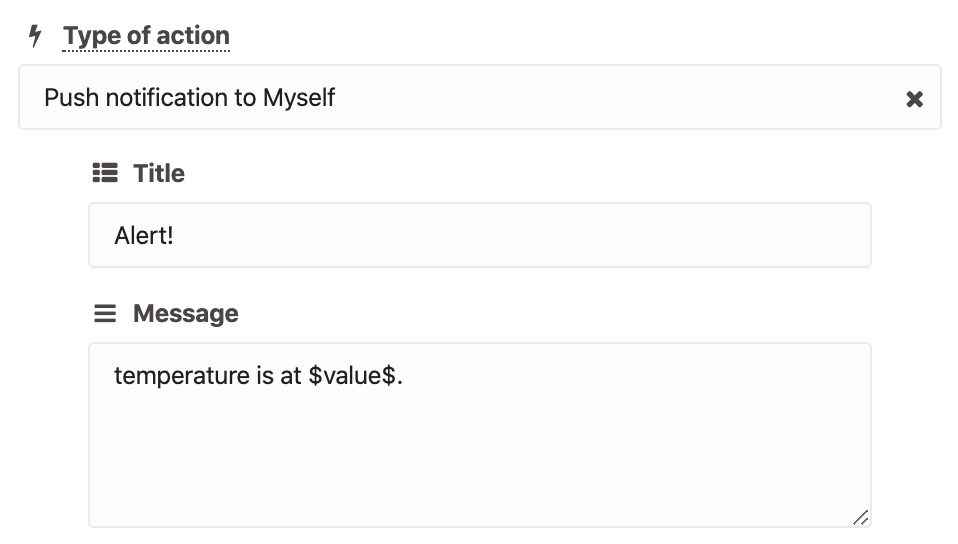

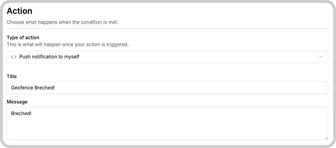

Push Notification to myself​
This action can notify you on your account via the Admin in your browser or through the TagoIO app. You can customize the title and content of the notification. In the message field, you can use variables to dynamically include information in your text. For more details on how to use message variables, refer to the "Message Variables" section at the end of this page.
Please note that the notification is only sent to the account where it was created.
Push notification action configuration

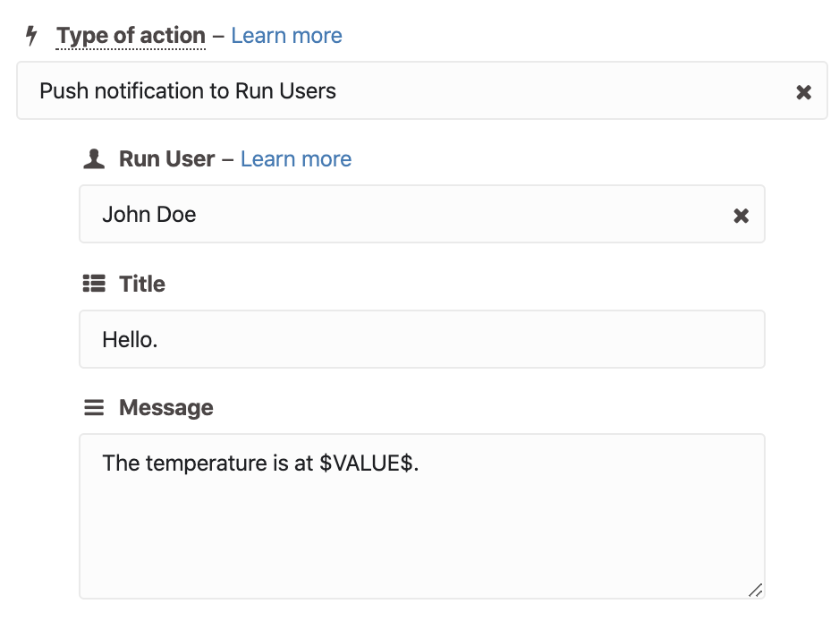

Push Notifications to Run Users​
Send notifications to designated Run Users within your Run. You must specify the particular Run User you wish to notify. For notifying multiple users, please refer to our documentation on notifications using analysis.

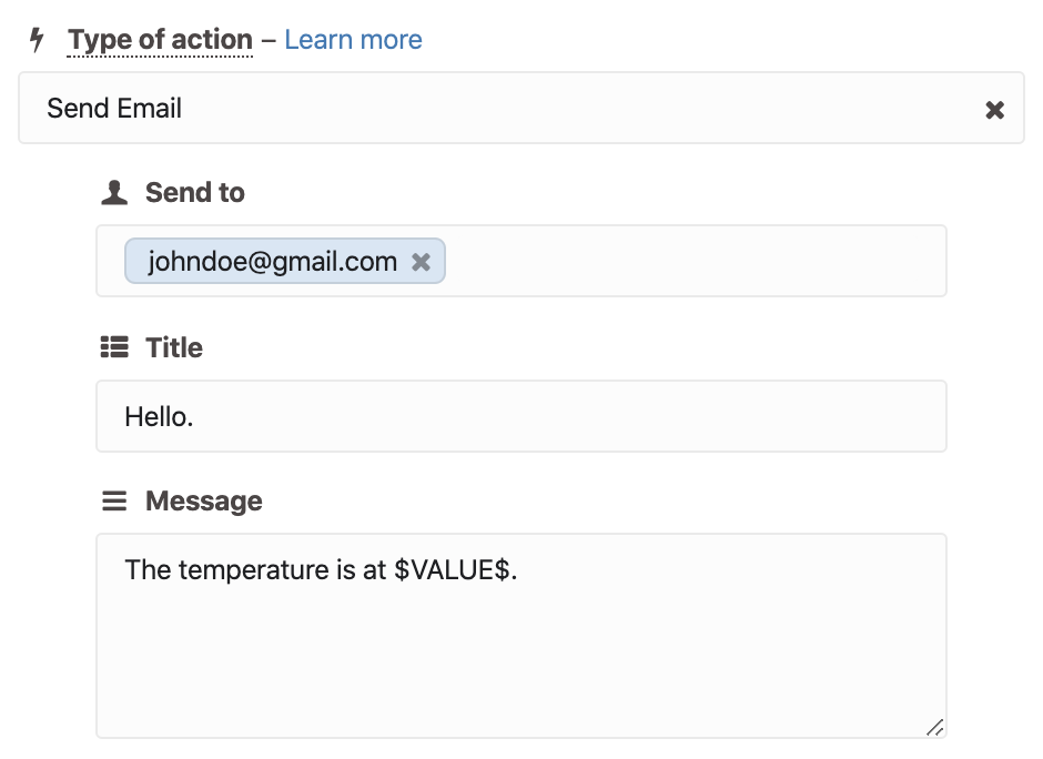

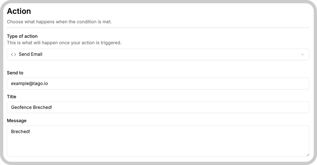

Send Email​
Sends an email to a specified address when certain conditions are met. You can specify one or multiple recipients by separating email addresses with a semicolon (;).
Image 3

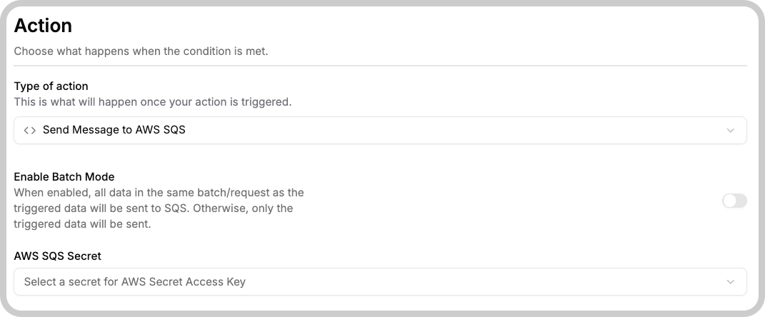

Send Message to AWS SQS​
This action sends messages to Amazon SQS when triggered. It requires authentication via Secrets. You will need to provide the region, queue URL, and access key id and secret access key.
Learn how to create this secret: Secrets.
Send Message to AWS SQS action configuration

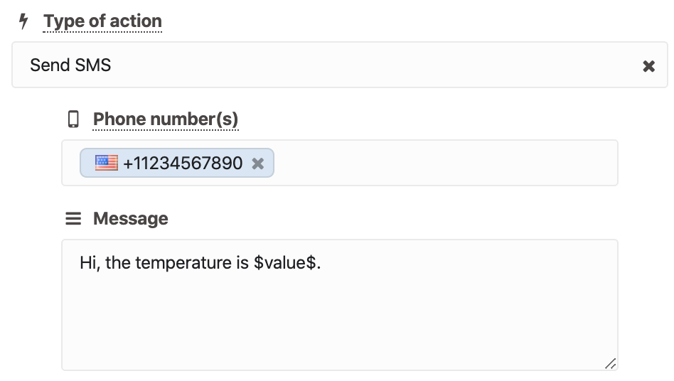

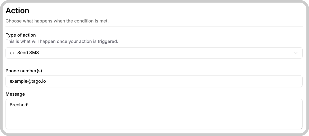

Send SMS​
Sends SMS messages when certain conditions are met. You can specify one or multiple recipients by separating phone numbers with a semicolon (;). You need to include the country code with each phone number; if omitted, the system assumes the USA code (+1).
Image 7
Some costs may occur when using the SMS service, which vary based on the country of operation. Check the pricing, terms of use, and your plan before using the SMS service.
Attention: starting on November 1st, 2024, TagoIO will no longer offer SMS services. We recommend integrating with external providers to send SMS using the "Send SMS with Twilio" action.

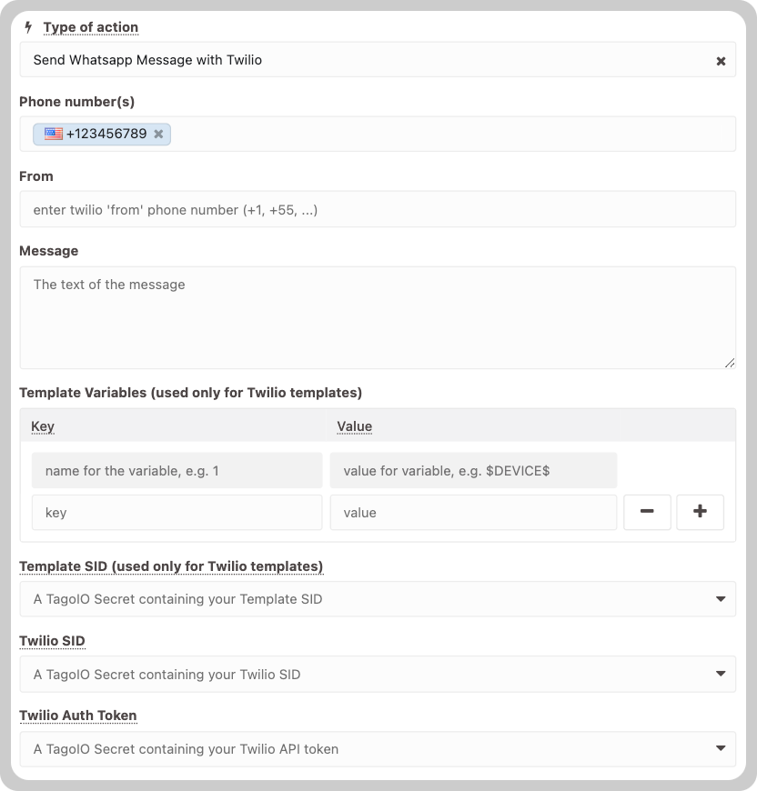

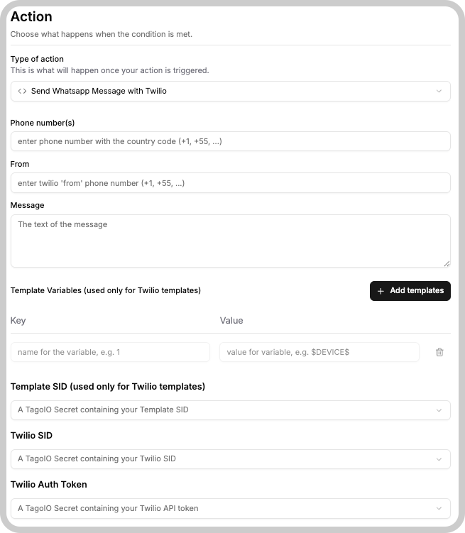

Send WhatsApp message with Twilio​
Use this action to send a WhatsApp message via Twilio when a specified condition is met. You will need to provide the recipient's phone number, the sender's "from" number, and the message content. The message field supports variables, allowing you to dynamically include information in your text.
Ensure that the Twilio SID and Twilio Auth Token are set in TagoIO Secrets beforehand for them to appear in the dropdown menu. Use a Secret of type Text. Learn how to create this secret: Secrets.
Image 12
You can send WhatsApp messages directly from scripts within the Analysis using the Twilio service. Before proceeding, ensure you review Twilio's terms of use and confirm your plan details. You must register your "From" number in the Twilio console before integrating it. The Twilio console also allows you to track the delivery status and view message content. Note that TagoIO does not charge for using this third-party Twilio service.
You can also send WhatsApp messages using Twilio Templates. To do this, you need to set a Twilio Template SID in TagoIO Secrets and configure the Template variables. Template variables also support dynamic content, allowing you to include information dynamically within them.

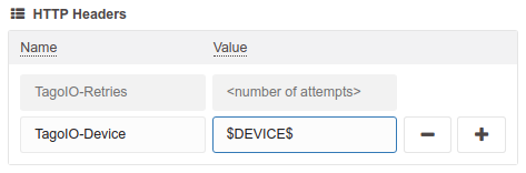

You can use payload fields in the HTTP endpoint, like the example above but with a variable (https://myapi.io/endpoint/$VALUE$), or even in the HTTP Headers like in the example below:
Image 16
The TagoIO-Retries header is managed by the TagoIO API and sent in every Post request for this Action type, and indicates the number of attempts to post the data to your endpoint.

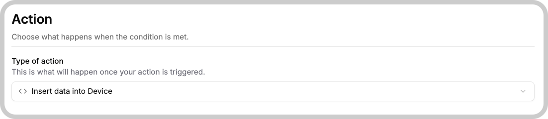

Insert to Device's data storage​
This option is only available if your Action is of the type MQTT Topic. This action will insert the data directly into the device's data storage.
Insert to Device's data storage action configuration
