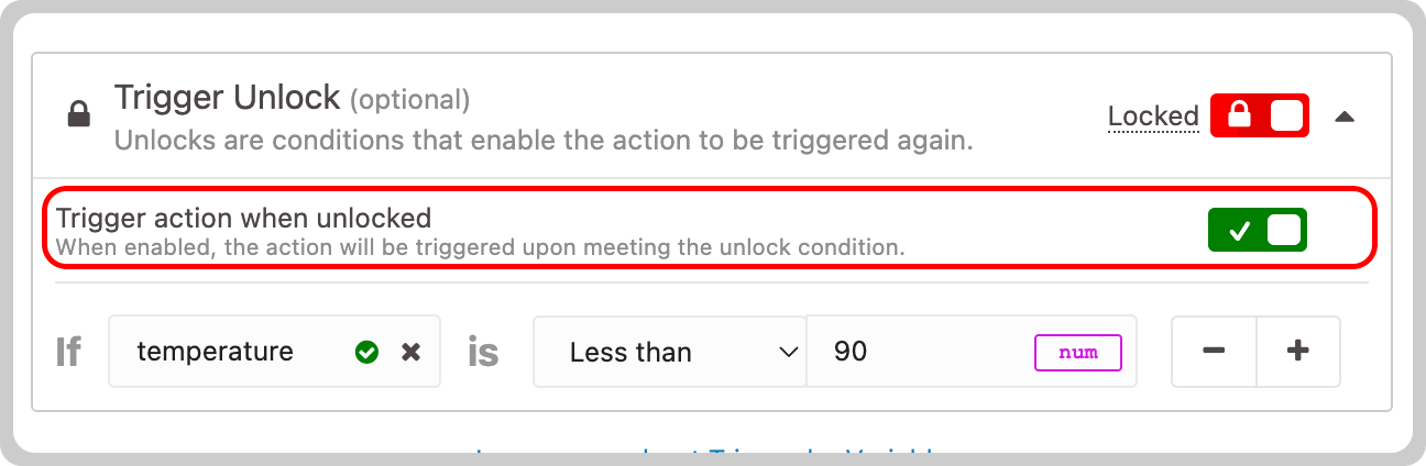

You can check if your action is locked by looking at the Locked switch, as shown in the screenshot below.
  • If the Locked switch is gray, it means your action is unlocked;
  • If it's red, it means your action is locked.
The lock button will only appear once you add at least one condition.
Image 1

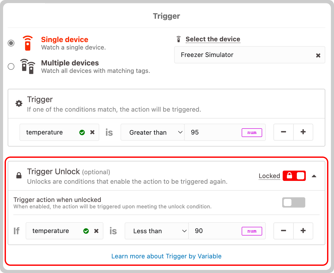

Unlock Condition Example​
You can also run the action again when an unlock condition is met. For example, if you are triggering an Analysis​ to set a device in alert mode due to high-temperature readings, you can also switch to safe mode upon meeting an unlock condition.
Image 2

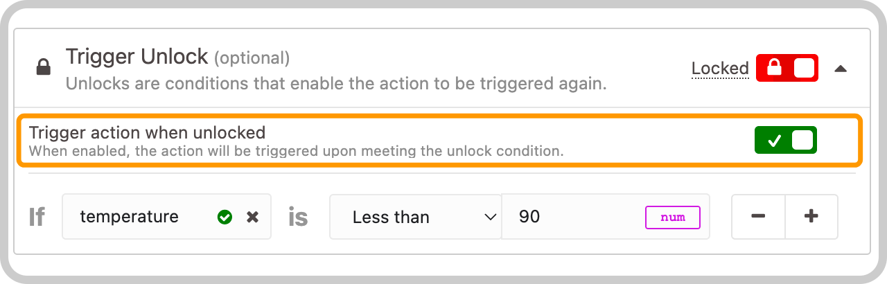

Duplicate Trigger Warning​
Enabling a trigger when unlocked can lead to a duplicate triggered action.

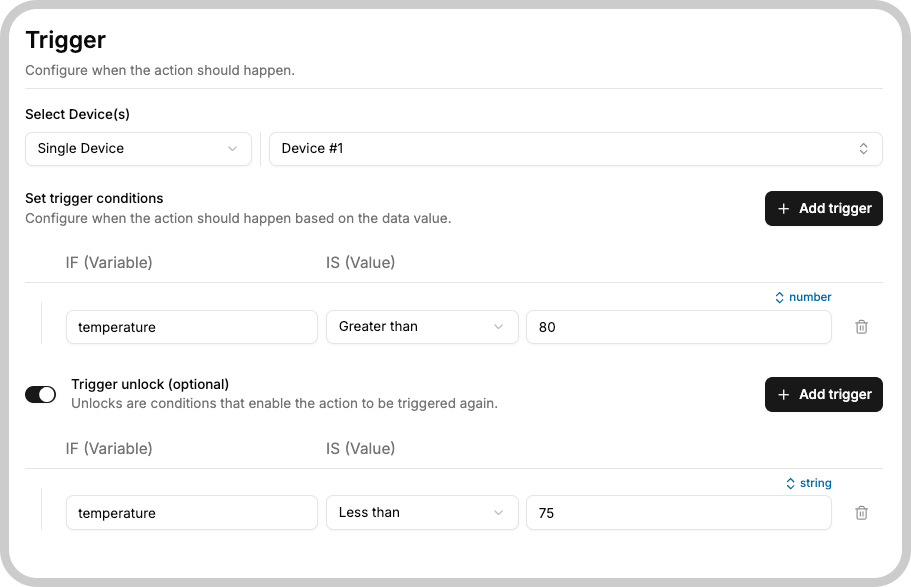

Why Does This Exist?​
One example of an undesirable situation could occur when you want to receive only one SMS when the temperature crosses above 95 °C, but instead, you receive one SMS for each time a new value of temperature above 95 °C is sent (95 °C, 96 °C, 97 °C).
You may want to implement a hysteresis using a Trigger Unlock condition. If you define the condition to reset when the temperature is less than 90 °C, for example, it would prevent this issue.
Only one SMS would be sent, and the system would remain locked until the temperature goes below 90 °C, which seems much more reasonable in this example.
