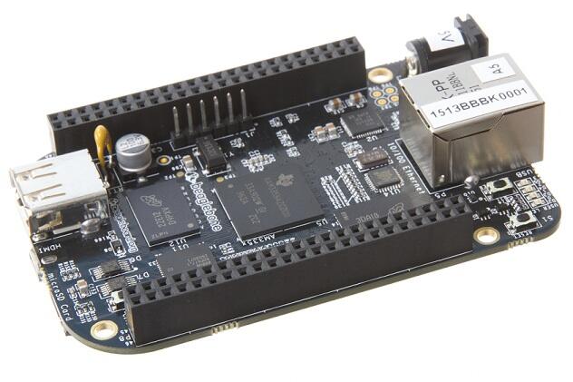

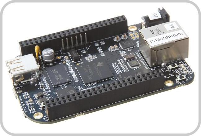

Beagle Bone Black
BeagleBone Black board
Overview​
This simple tutorial uses the BeagleBone Black (BBB) board to demonstrate key principles for integrating your solution with TagoIO. Beyond connecting the BBB to the cloud, you will learn how to structure and reuse this code in your own application.
The circuit uses a single digital input connected to a normally open switch on connector P8 pin 19. A 2.2 kΩ resistor pulls the line low (0 V) when the switch is closed, which gives a clean signal for the BBB's GPIO pin.
