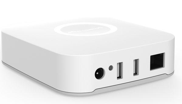

SmartThings Hub from Samsung
The Zooz Zen15 Power Switch connects to the SmartThings hub using Z‑Wave wireless technology. The Zen15 can control loads and measure power and energy in real time so data can be displayed and processed by TagoIO.
