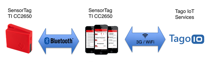

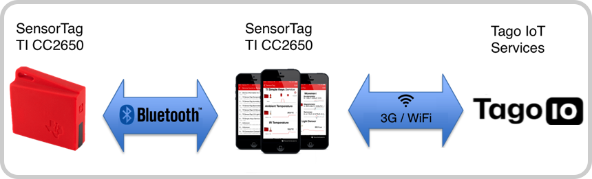

The SensorTag communicates with a mobile device over Bluetooth. Texas Instruments provides a mobile app that converts that Bluetooth communication into MQTT and forwards the data to the cloud over cellular or Wi‑Fi.
Connectivity Diagram​
SensorTag to TagoIO flow diagram
