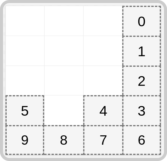

  • display.buttons: This field is required and defines all custom buttons inside the keypad widget. Each button's position corresponds to its index in the array (0-based). For example, the image below shows how each index maps to a physical key on the keypad: Image 1
