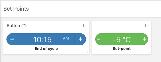

Step Button Widget
Step button allows users to increase and decrease values of a number or clock by using the (-) and (+) buttons.
Step Button examples showing time and temperature controls with labels "Button #1", "10:15 AM", "End of cycle", "-5 °C", "Set-point"
You can also define the incremental step value and the allowed limits.

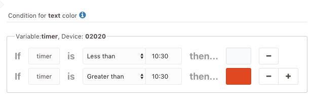

Color from Metadata​
You can control the colors of the Step Button widget by using information stored in the metadata of the variable.
  1. In the Visualization tab, set Override colors with the conditions defined here to False.
  2. Inside the metadata, include the following fields:
    "text_color": "white",
    "button_color": "blue"

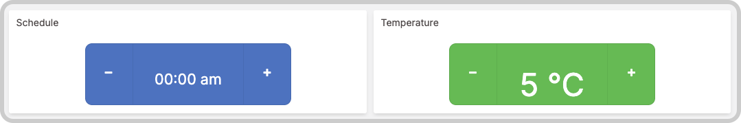

  3. Example using HEX or RGB values instead of color names:
    "variable": "set_point",
    "value": 5.3,
    "unit": "°C",
    "metadata": {
    "text_color": "#FFFFFF",
    "button_color": "rgb(44, 144, 223)"
tip
You can always enter colors using #HEX or RGB values instead of a color name.
