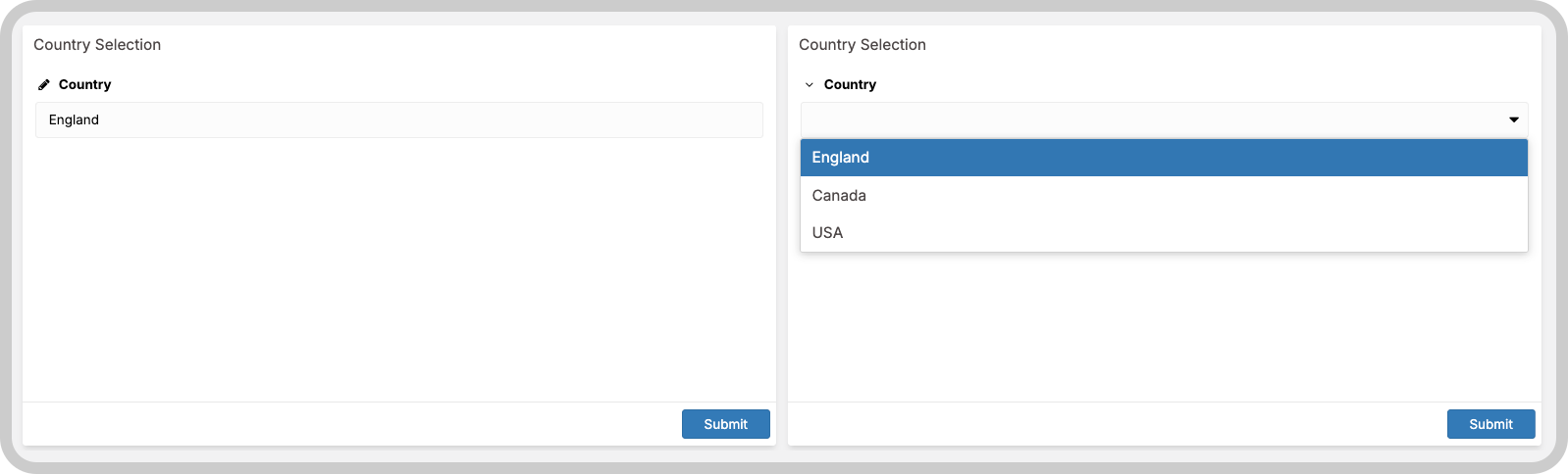

Dynamic Dropdown allows users to populate a dropdown list with dynamic items coming from a variable. The example below shows how a Dynamic Dropdown can present selectable country values that are updated dynamically.
Country selection example
