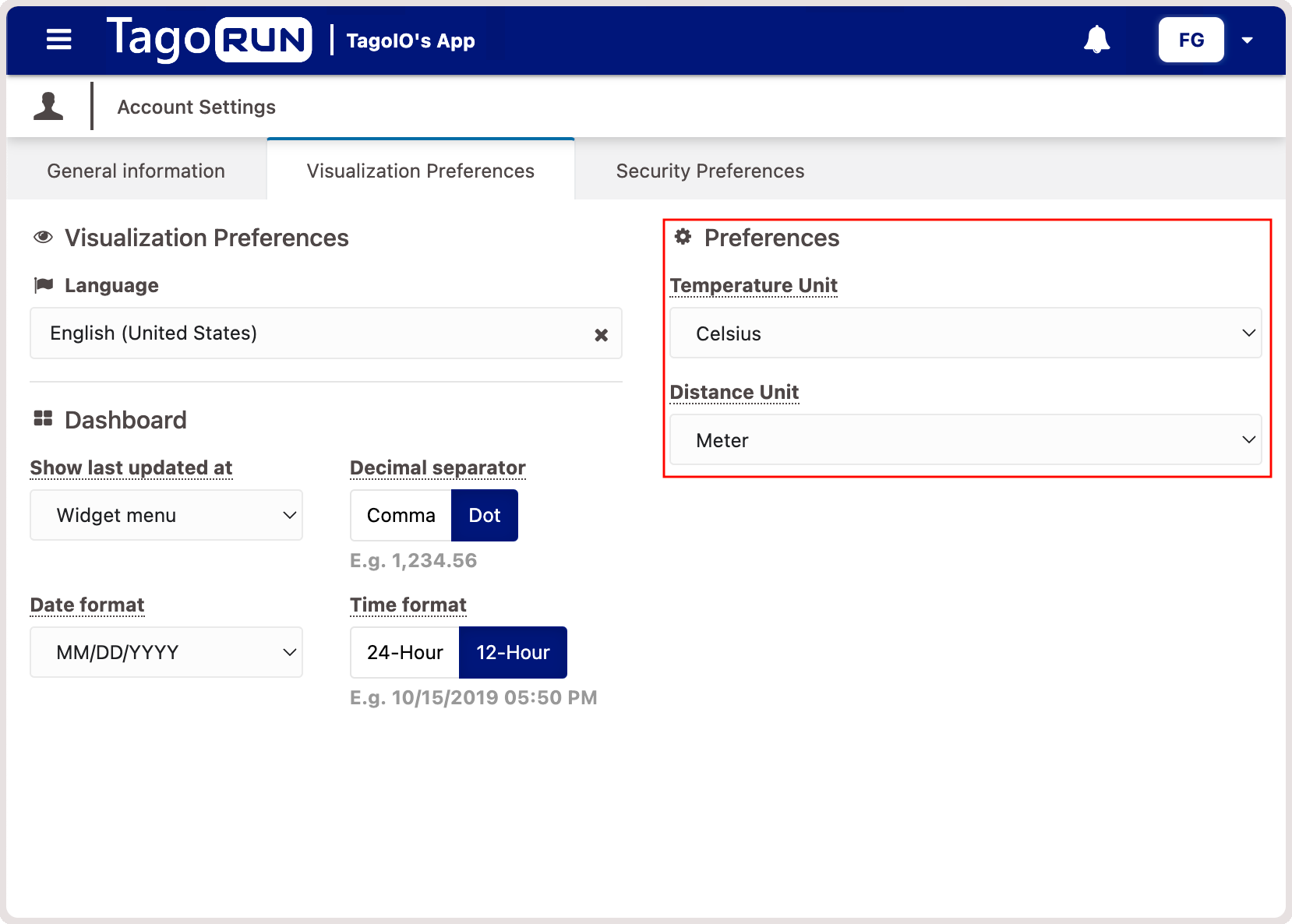

Custom Settings is a feature that lets you create unique visualization preferences for your end-users that extend beyond TagoRUN's default settings. After you configure custom settings, they will appear in your end-users' Account Settings.
With Custom Settings you can tailor preferences to specific needs: for example, selecting preferred units for visualizing temperature and distance, or choosing decimal, date, and time formats. These settings can be used together with Dynamic Formulas to ensure displayed data matches user expectations.
Custom Settings on TagoRUN portal

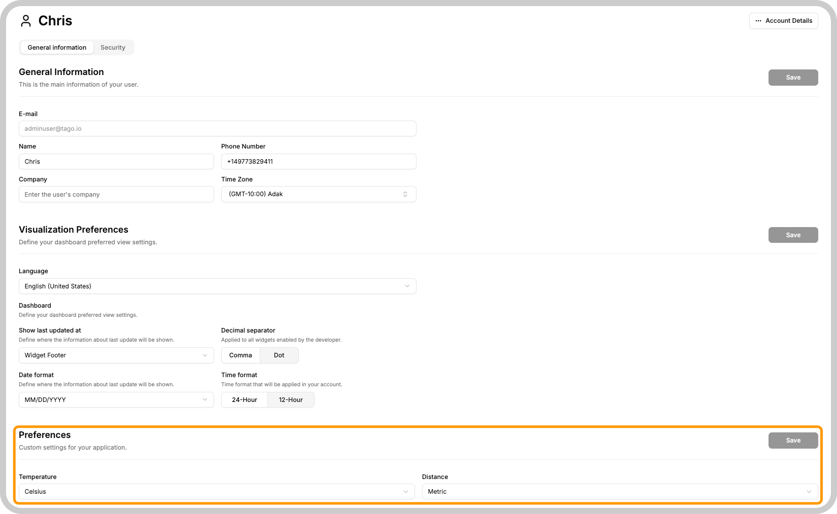

Once you have created your Custom Fields and deployed your updated RUN, your users can select their preferences by navigating to the Visualization Preferences tab on their Account page.
