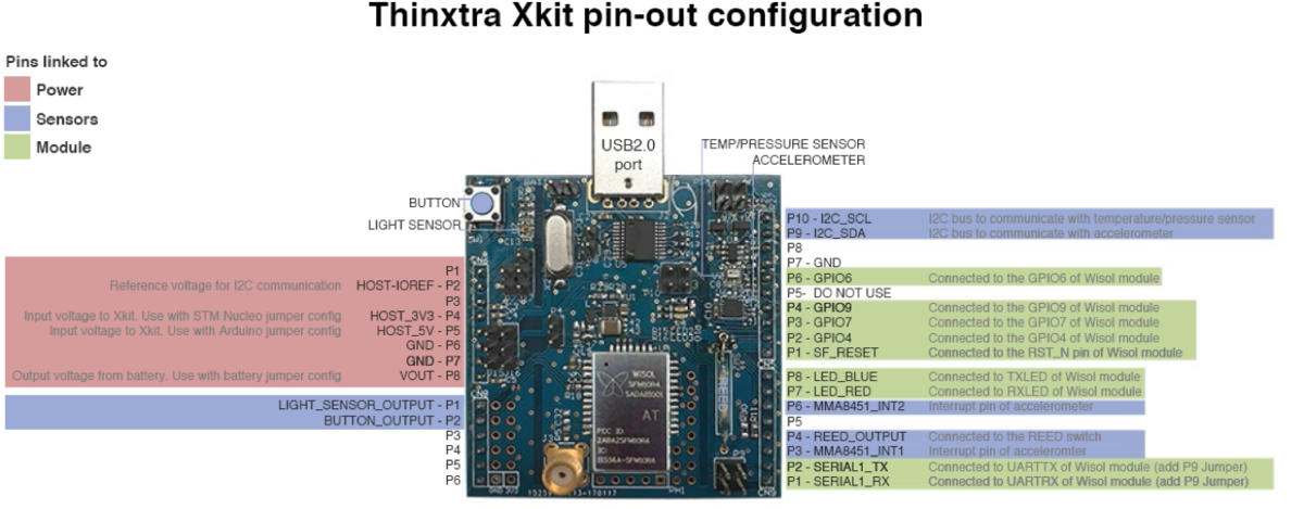

Here is a diagram of the Xkit board's pinout. For more details, click here.
Pinout Diagram
Thinxtra Xkit pin-out configuration
(Note: The image above shows the Thinxtra Xkit pin‑out configuration including a color legend for pins linked to Power, Sensors, and Module.)

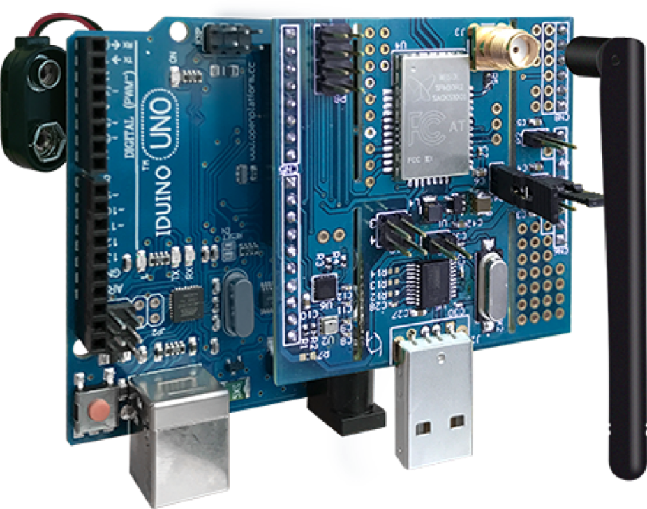

Xkit Board
Xkit board
