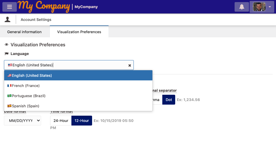

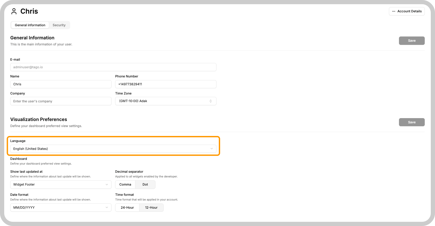

End-users language selector
End-users can select the language in their applications.
info
End-users are able to switch languages within their accounts. By default, the system will use the language identified by their browsers. If the language is not available in the application, the system will default to the Fallback language.

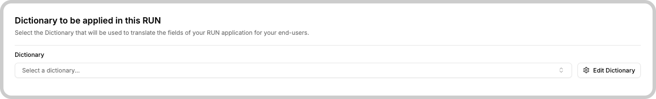

3) Configure the language for your RUN​
Dictionary can also be applied in your RUN application so that you can configure additional texts used in common places (e.g., 'Save' button, sign-in form, tooltips). If you haven't done so, create a dictionary to be used as a baseline by accessing the [RUN] >> Main Configuration section. The system can create a dictionary with all available Keys for editing or use it as a basis for other languages.
RUN Multi-language
This dictionary will also contain the Keys used in your TagoRUN mobile app.
