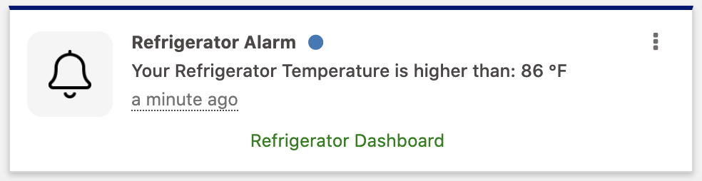

Notification example showing a Refrigerator Alarm card with a call-to-action link

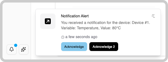

When sending a notification using Analysis, the primary interactive feature is buttons. You can include up to four buttons in a single notification. Each button can be configured to perform one of several behaviors:
  • Redirect to a TagoIO page.
  • Redirect to an external link.
  • Trigger an Analysis when pressed.
You also have a few customizable options:
  • Set the button label.
  • Set the button color.
