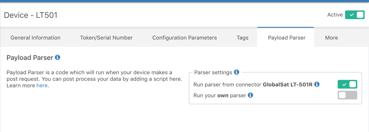

TagoIO can run up to two parsers for a device:
  • The Connector parser (added automatically during device creation)
  • Your own custom parser (optional)
info
The parsers are executed in sequence. First the one from the Connector, then your custom parser.
Connector type
The connector type is defined based on your selection from the list of devices during the Add Device step. The connector contains the script necessary to work with that device.
Parser settings
Parser settings to enable the parsers
The script contained inside the parser from the Connector is not visible.

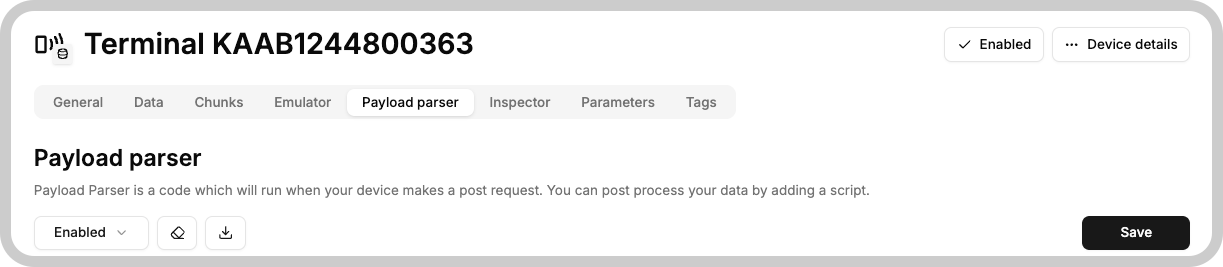

How is the Payload Parser triggered?
Image 2
The payload parser is automatically triggered every time the device sends data to TagoIO (no need to set up anything). Your payload parser is the first step that gets triggered before saving data in the Device's data storage, so if your code has an error it will be returned directly to the device HTTP post response.

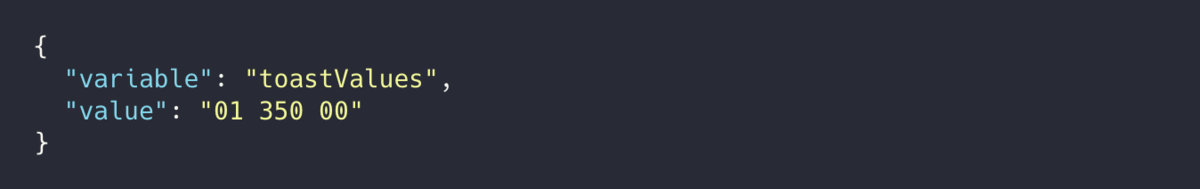

A toaster could send data to TagoIO when your bread is toasted in the following format:
"variable": "toastValues",
"value": "01 350 00"
The value above could represent XX YYY ZZ. Where:

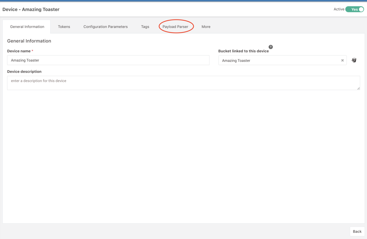

Let's code the Payload Parser to transform that payload into real variables. First, click on your Device and go to the Payload Parser tab.
Image 5

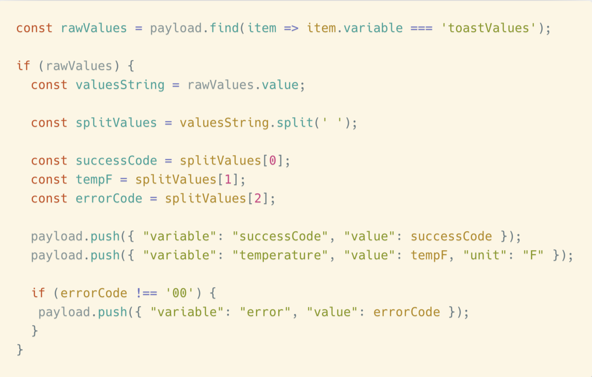

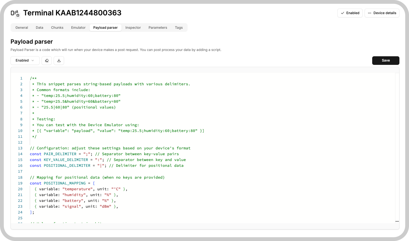

On the Payload Parser tab you will see the code editor. Then, you can write the following code:
const rawValues = payload.find((item) => item.variable === "toastValues");
if (rawValues) {
const valuesString = rawValues.value;
const splitValues = valuesString.split(" ");
const successCode = splitValues[0];
const tempF = splitValues[1];
const errorCode = splitValues[2];
payload.push({ variable: "successCode", value: successCode });
payload.push({ variable: "temperature", value: tempF, unit: "F" });
if (errorCode !== "00") {
payload.push({ variable: "error", value: errorCode });
Save, and you are ready. Now, every time the toaster sends those variables, the parser will transform it into real variables, and you can use them to build Dashboard, Analysis, or Action.
