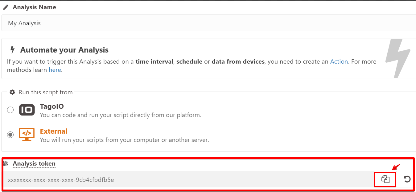

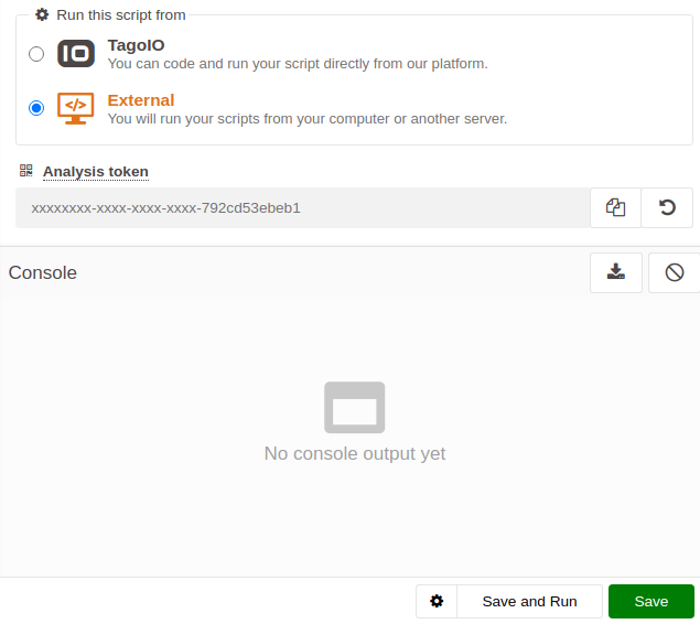

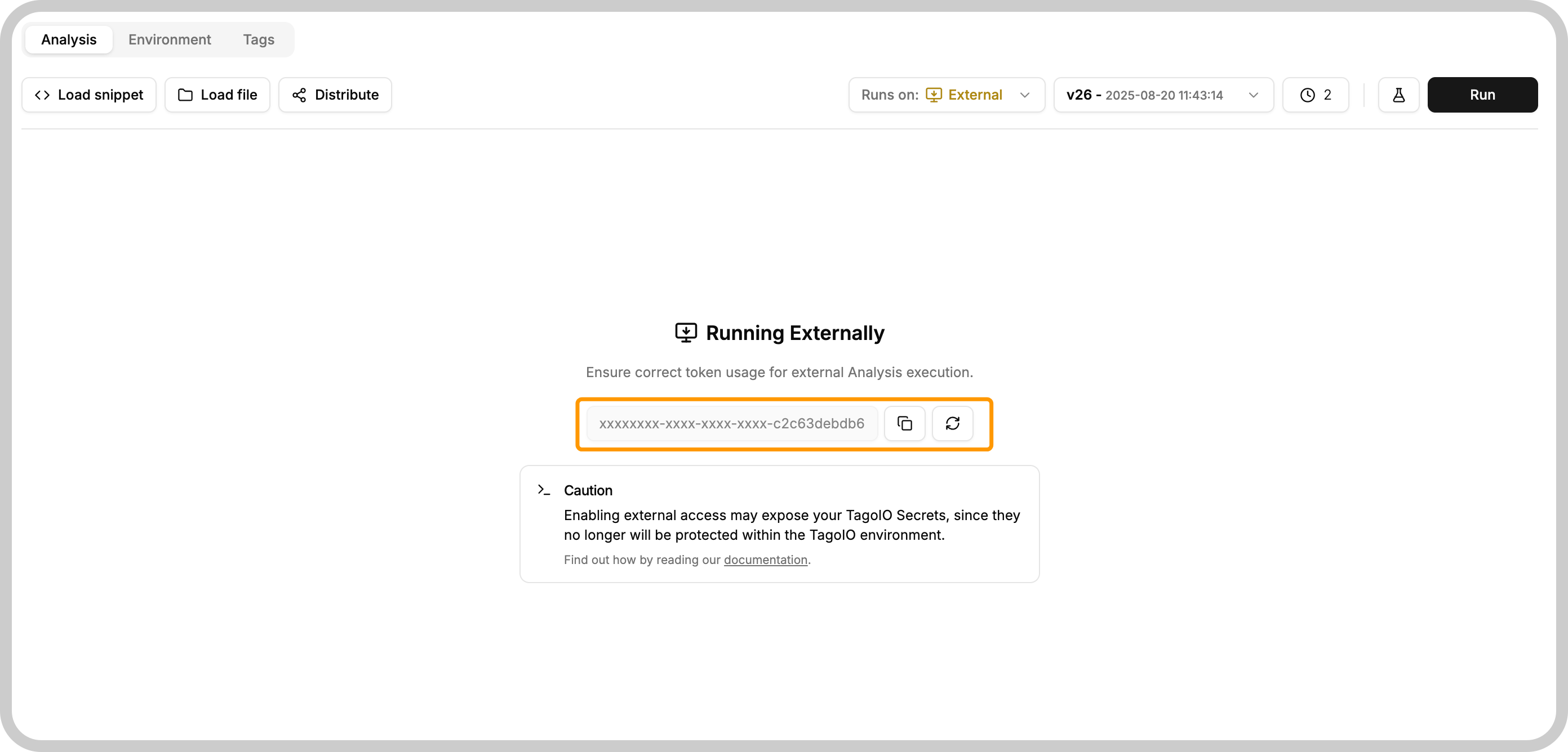

After the code and the environment are set, you only need to make sure you put the right Analysis token into your analysis file.
To do that, every analysis has the following line below. Replace MY-ANALYSIS-TOKEN-HERE with your analysis token:
module.exports = new Analysis(myAnalysis, { token: "**MY-ANALYSIS-TOKEN-HERE**" });
You can get the analysis token by accessing your analysis page at TagoIO and selecting External for "Runs on". Create a new analysis if you don't have any.
Image 2

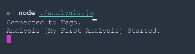

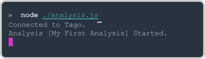

Now run the script from your command line:
node ./analysis.js
You should see a prompt similar to this:
Image 3

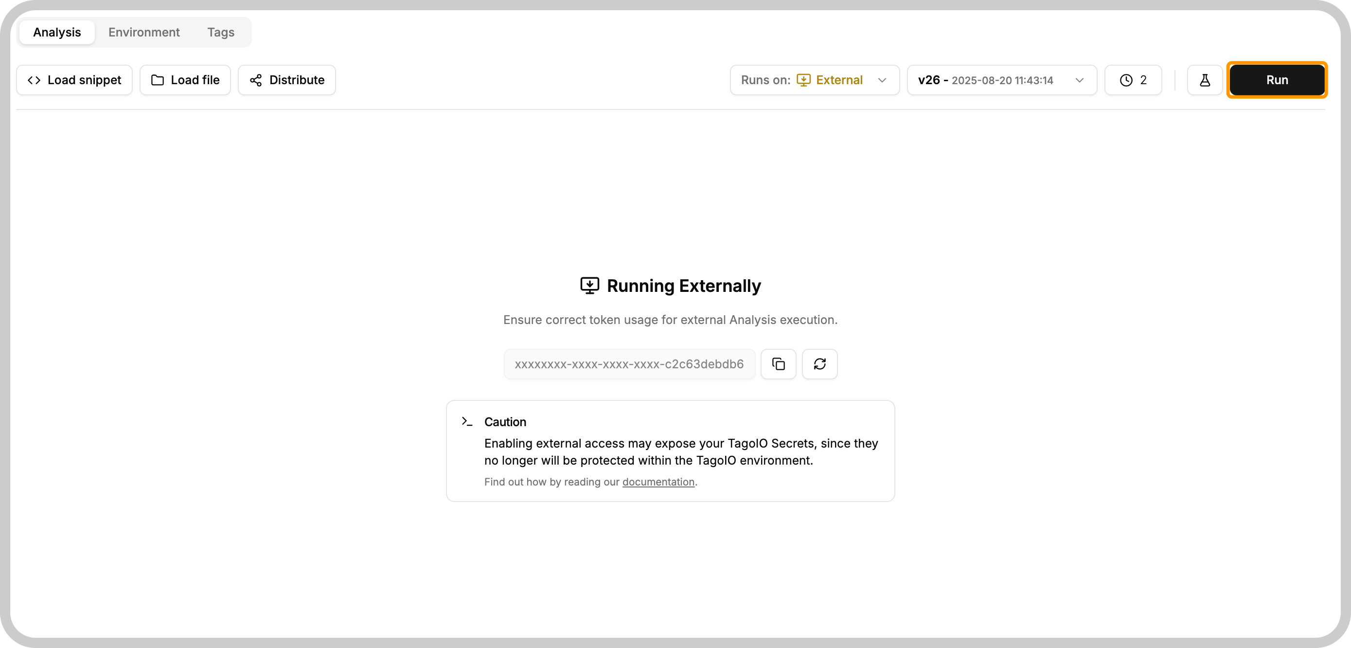

Go back to TagoIO and click Run to run your script. You can also configure an Action to run your script automatically.
Image 4
