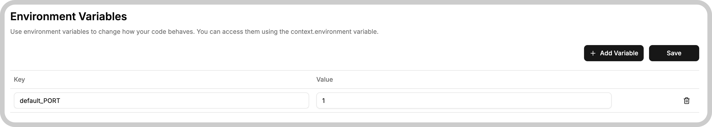

In the environment variables UI (see image above):
  1. New Environment variable: Add or remove an environment variable using the plus/minus buttons (marked as 1 in the image).
  2. Variable Key: The variable name (marked as 2 in the image). This is the key you will use in context.environment (e.g., MY_TOKEN).
  3. Variable Value: The value of the variable (marked as 3 in the image). Values can be integer or string; convert or parse values in your code as needed.
You can have up to 20 environment variables per Analysis. If you exceed this limit, the UI will display a notification indicating that the maximum capacity has been reached.
