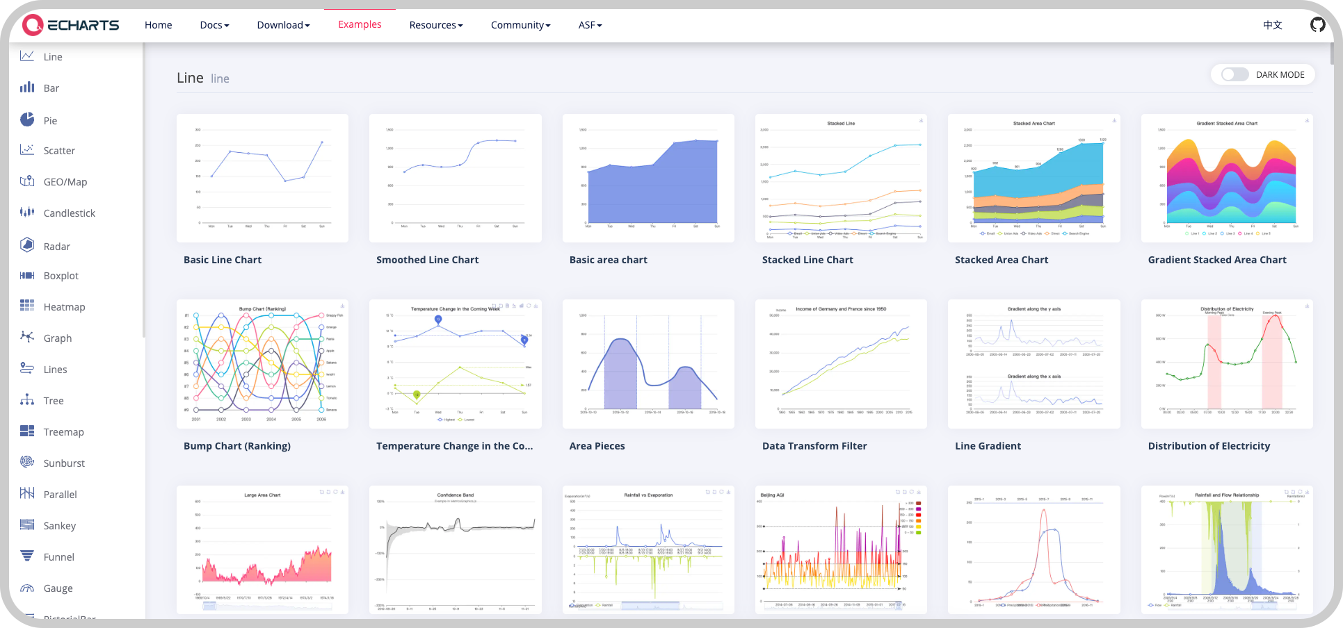

In this tutorial, we will guide you through creating a Ring Gauge custom widget that displays multiple variables simultaneously in an interesting format.
To achieve this, we use the ECharts library, a highly customizable charting library that simplifies the development of interactive and visually appealing data visualizations. Using ECharts can greatly speed up development and help ensure the custom widget is both efficient and aesthetically pleasing.
