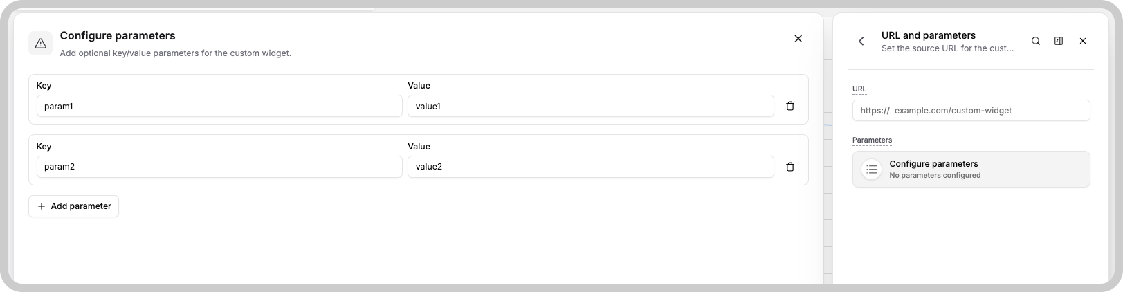

Custom widget parameters table
Each parameter has a unique key and a value. The key is used in your code to retrieve the parameter's value.
Note: You can specify up to 20 parameters.
