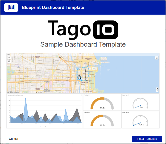

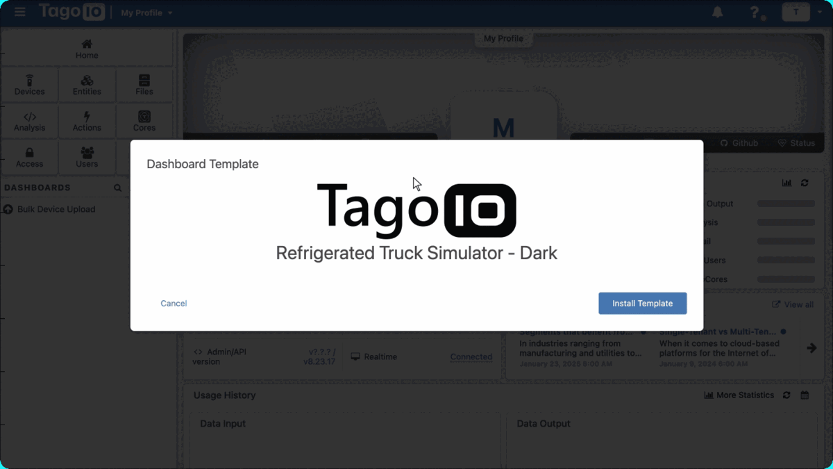

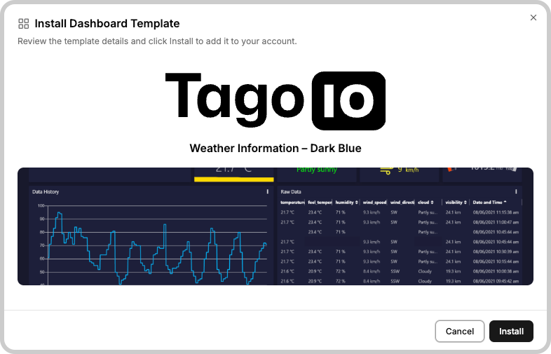

When people click the link you provide, they will be taken to a screen similar to the one shown below. Both the images and the text on the installation page are fully customizable.
Blueprint Dashboard Template, Sample Dashboard Template screenshot showing TagoIO logo and sample widgets

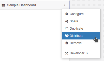

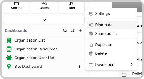

To distribute a dashboard, first click on the options menu of your dashboard, and then on the Distribute option.

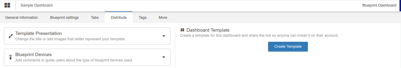

This form will be displayed:
Image 3

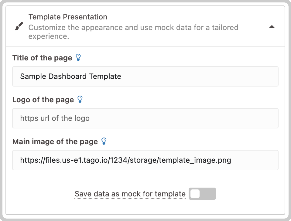

The Distribute function relies on creating a customized install page for anyone to install a copy of your dashboard. In the image above, you can set a custom title for the install page in the field Title of the page. You can also replace the default images with custom ones using the fields Logo of the page and Main image of the page.
Image 4

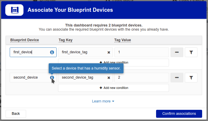

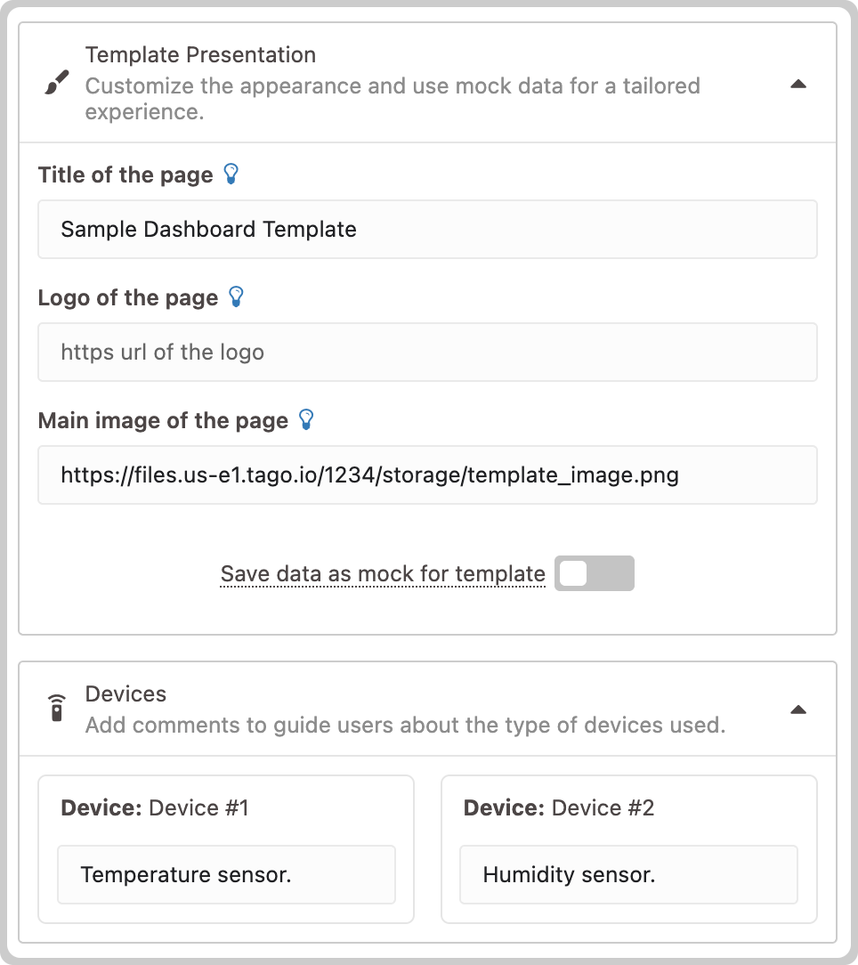

You can add descriptions to your Devices, or Blueprint Devices, and Analyses used on the dashboard as well. Descriptions are optional, but they help whoever is installing the template to find their own devices to associate with the ones used on the dashboard.
For example, specifying that one of the devices is a temperature sensor in the description allows the user installing the template to select a matching device on their own profile.

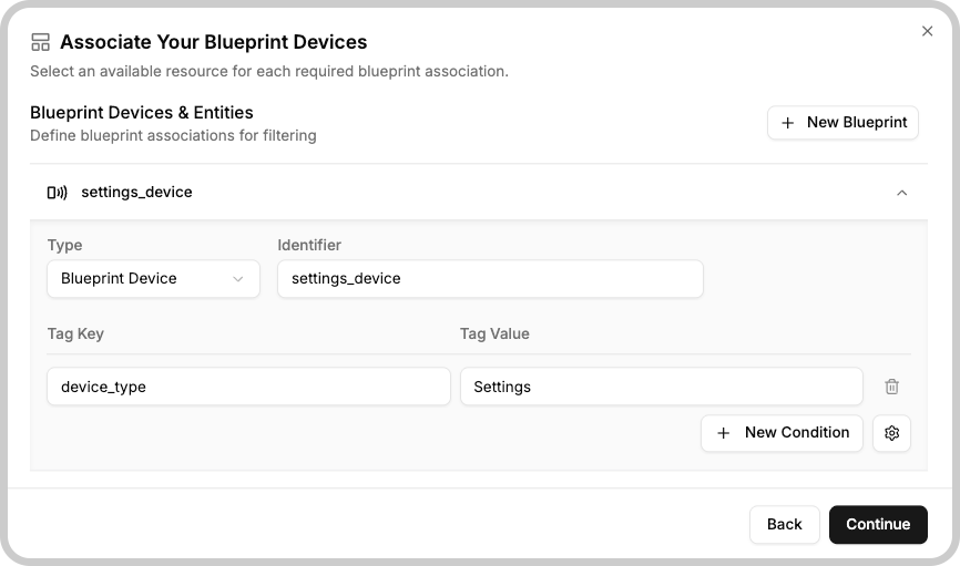

When using a template for a Blueprint dashboard, the Blueprint Devices will be configured exactly like in the dashboard, but with helpful descriptions in case the user needs to make any changes. This also lets the user know which tag keys and values the devices must have configured.
If the dashboard has no Analysis in its widgets, this is the only step and clicking Create Dashboard will install the dashboard.

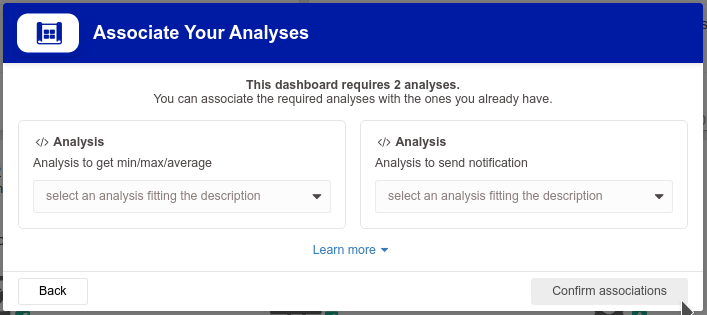

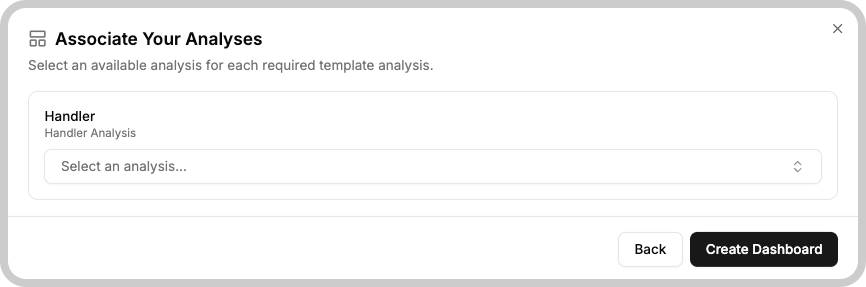

If the dashboard has Analyses, instead of Create Dashboard the button will be Continue and it will guide the user to another page to select their own Analyses to be used in place of the Analyses in the original dashboard.
Note that Analyses also have the Distribute feature, and they can be installed previously to installing a dashboard requiring Analyses. Read more about Distributing analysis.
Image 7
Selecting the required Analyses will enable the Create Dashboard button, and the template will be installed using the configurations made on this setup wizard.
