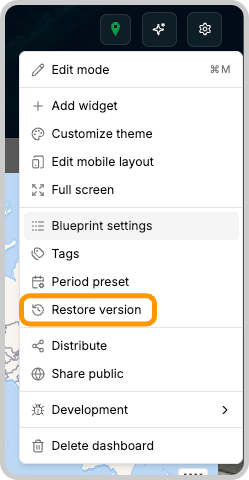

Accessing the restore option​
To access the restore feature, open your dashboard in edit mode and click the "Restore dashboard to a previous version" button.

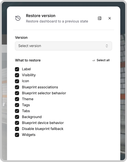

Advanced Settings​
In the Advanced settings section, you have fine‑grained control over what is restored. For instance, if you want to retrieve only the tags from a previous version, simply select the tags; all other elements remain unchanged. By default, the system restores the entire dashboard.
