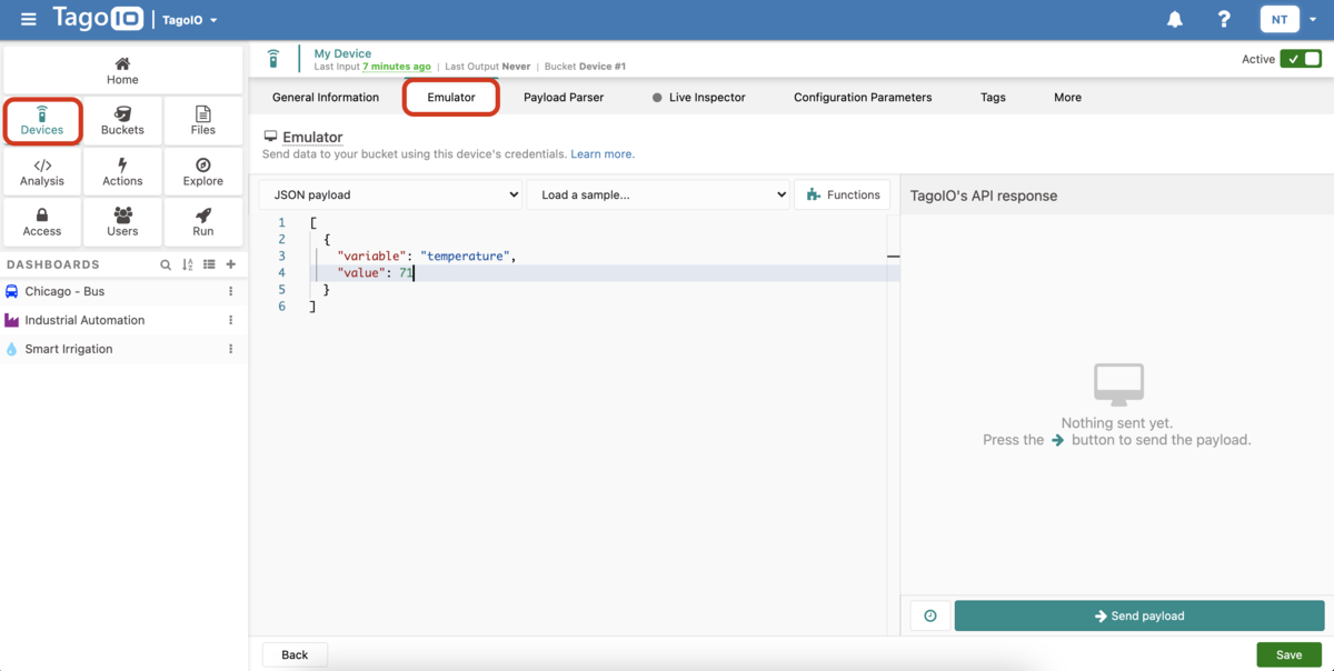

If you want a quick way to send data to your applications but don't have your hardware device available, or you simply need to send data to debug your applications, you can use the Device Emulator.
To access the emulator, go to Devices, select the device, and then click on the Emulator tab.

Below is a simple JSON example you can use in the Emulator payload editor:
"variable": "temperature",
"value": 7
Sending the payload
- Enter your payload in the Emulator editor.
- Press the Send payload button (▶) to send the payload.
- TagoIO's API response will appear in the right‑hand panel labeled “TagoIO’s API response”. If nothing has been sent yet, the panel will display: “Nothing sent yet. Press the ▶ button to send the payload.”
