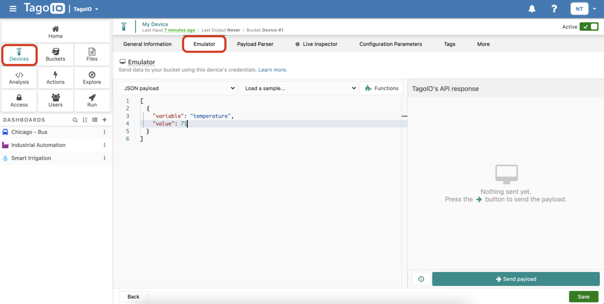

The device emulator is a tool for developers to send data as if it were coming from a real device. The emulator is intuitive and requires just a few clicks to validate and send your data package.
To access the device emulator, go to the Device section, select the device, and then click on the Emulator tab.

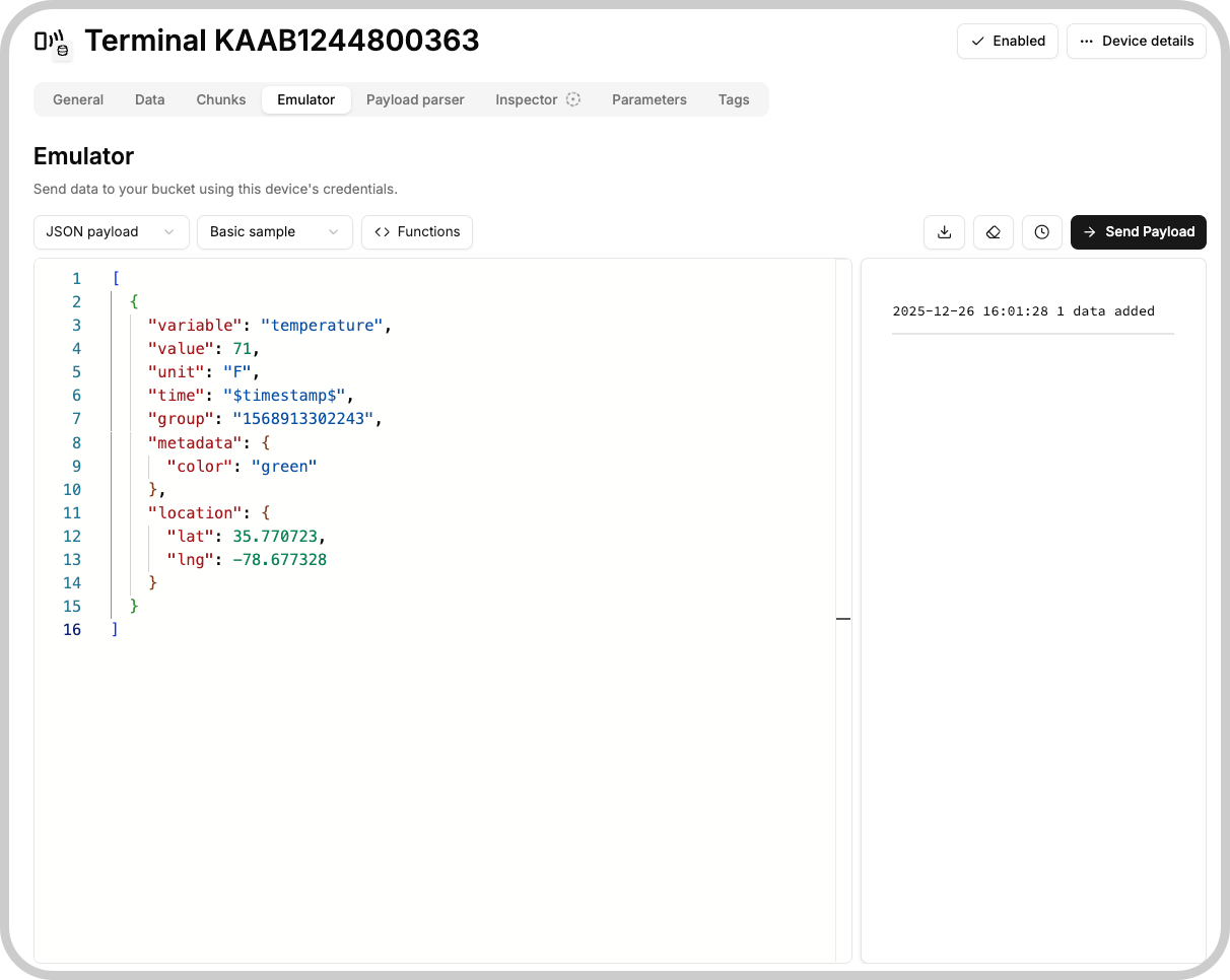

- Use the Emulator tab to validate and send payloads using the device's credentials.
- The emulator UI includes a payload editor, an option to load samples, function helpers, and a Send payload button to submit the data.

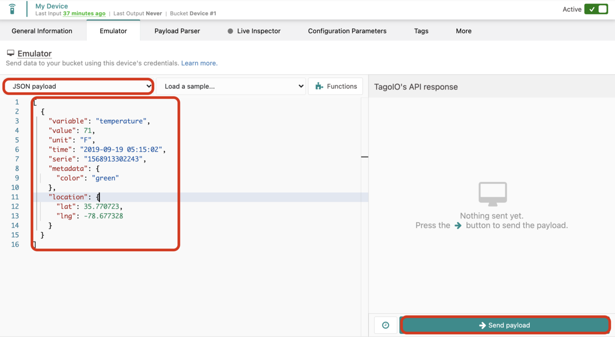

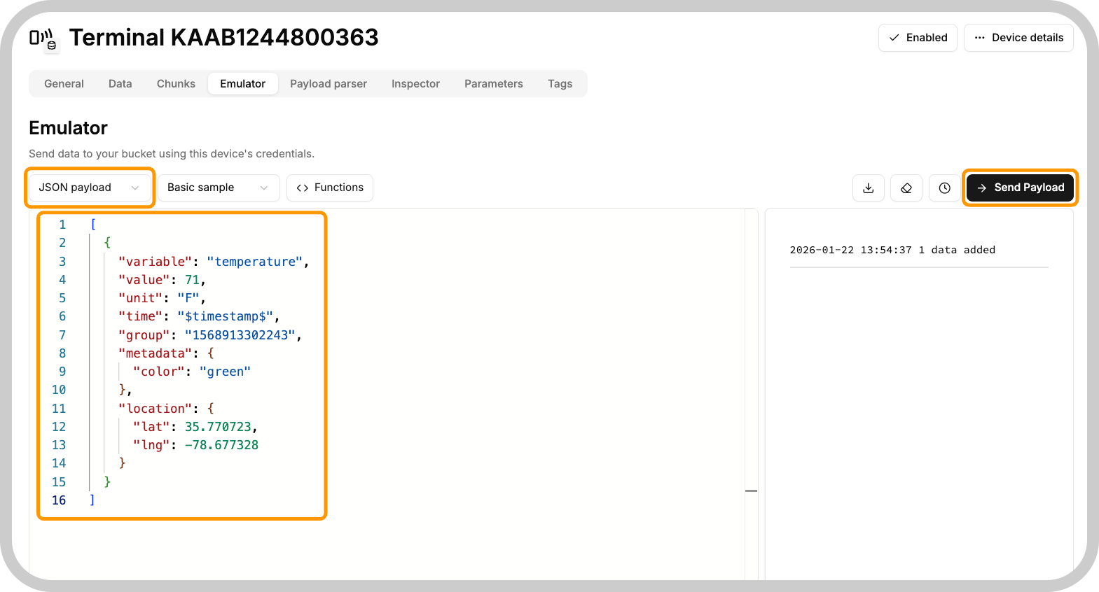

Sending Payload Data
To send a JSON payload from the emulator, you will need to:
- Build a data payload that should contain at least the
variable
field (pick one example from the list); - Edit the fields of the payload;
- Click on Send button to send the payload.

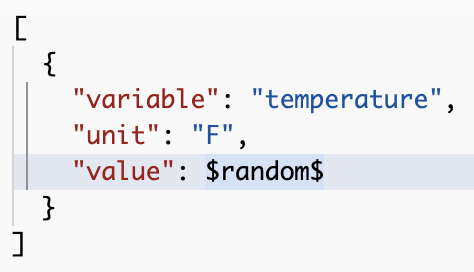

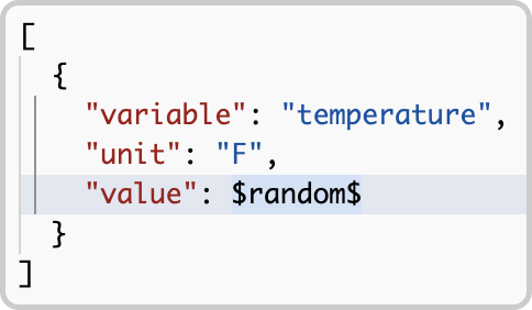

Functions
Functions are helper variables that you can add to your payload. Each function has a purpose. To add a function to your payload, click on Add function button and select a function.
To learn more about using functions in the device emulator, read the article Device Emulator Functions.

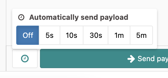

Timer
The timer helps to automatically send your payload at a fixed time interval. This is extremely useful if you wish to see the data coming in while you look at a dashboard, for example.
If you close the Emulator tab, the system will stop sending payloads. You may want to use the Simulator or create a script to keep sending all the time.
