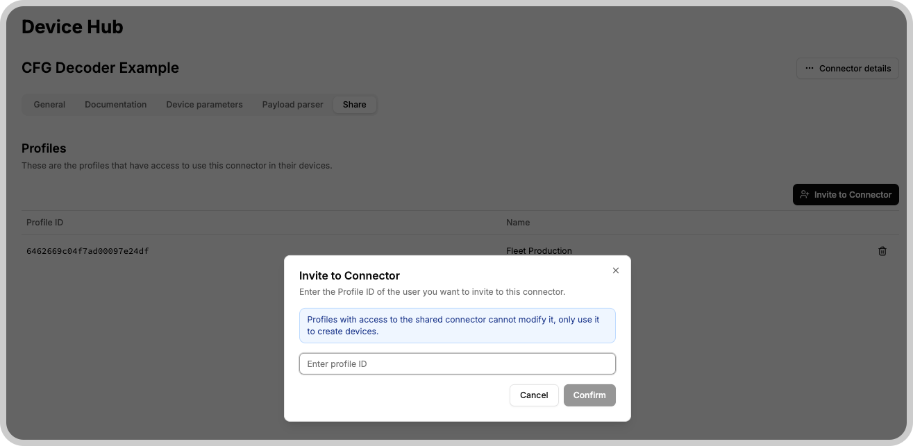

To share a custom Connector or Network with another Profile:
  1. Go to the Integrations page.
  2. Select the connector or network you want to share.
  3. Open the Share tab.
  4. Click on the "Invite to Connector" or "Invite to Network" button.
  5. Enter the Profile ID of the person you want to share it with.
  6. Click the Share button.
Note: Profiles with access to the shared connector cannot modify it; they can only use it to create devices.
