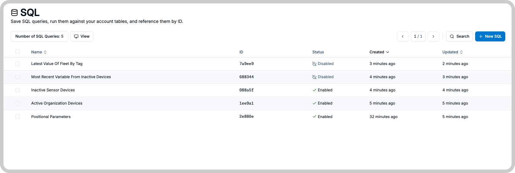

Once a query gives you the rows you want, save it so you never have to paste it again. A saved TagoSQL query is a resource on your profile, like a device or an analysis: it has a name, tags, a version history, and its own settings. Store the query once; widgets, analyses, and applications execute it by id.
New to TagoSQL? Start with Getting started for query examples to save.
Saved SQL queries listed with their id, status, and last update
