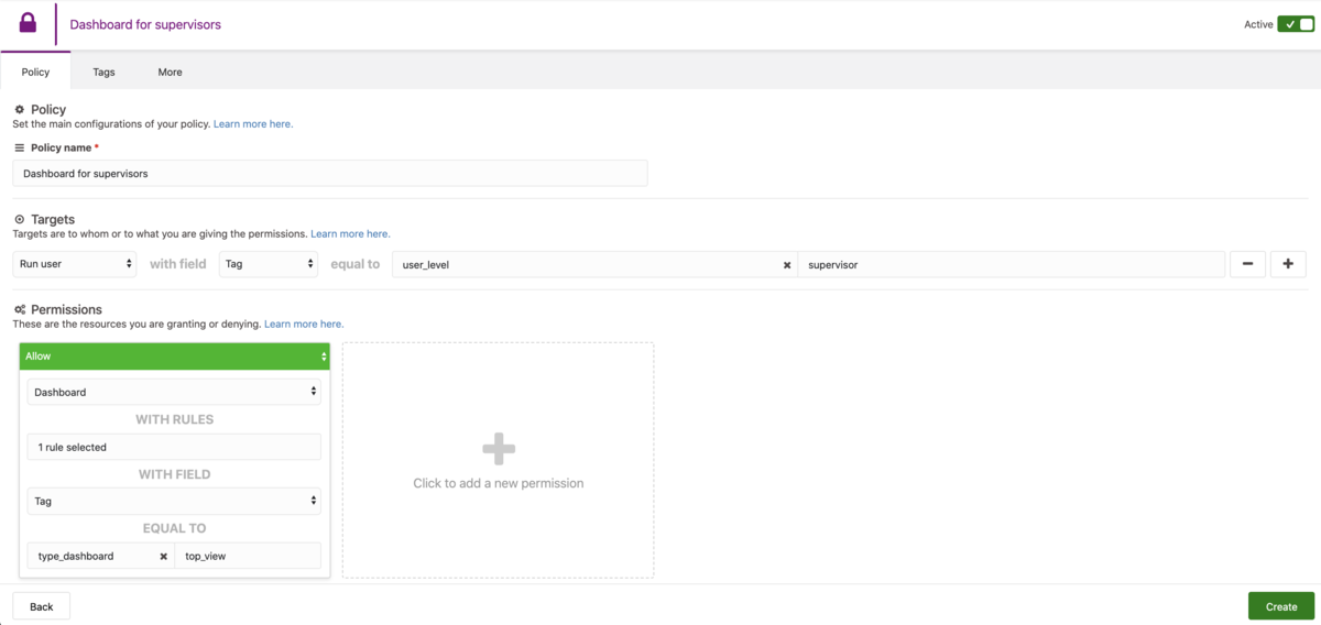

Share one specific dashboard only with users that contain certain tags. Example: Share the dashboard "Regional Sales View" with users who have the tag
level = supervisor

Share all my dashboards with all users. For this, you just need to set the field in Targets like
Run User = Any
, and thePermissions = Any
to share everything with anyone. -

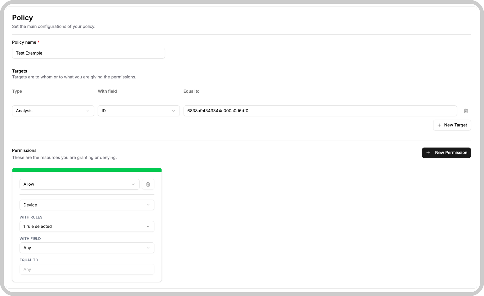

Allow an Analysis to do a bulk device upload. Example: An Analysis with the tag
script = device_upload
, and thePermission = device
with rulesCreate
and with fieldAny
By using the option Any
in the matching fields, you expose all that resource without restrictions.
