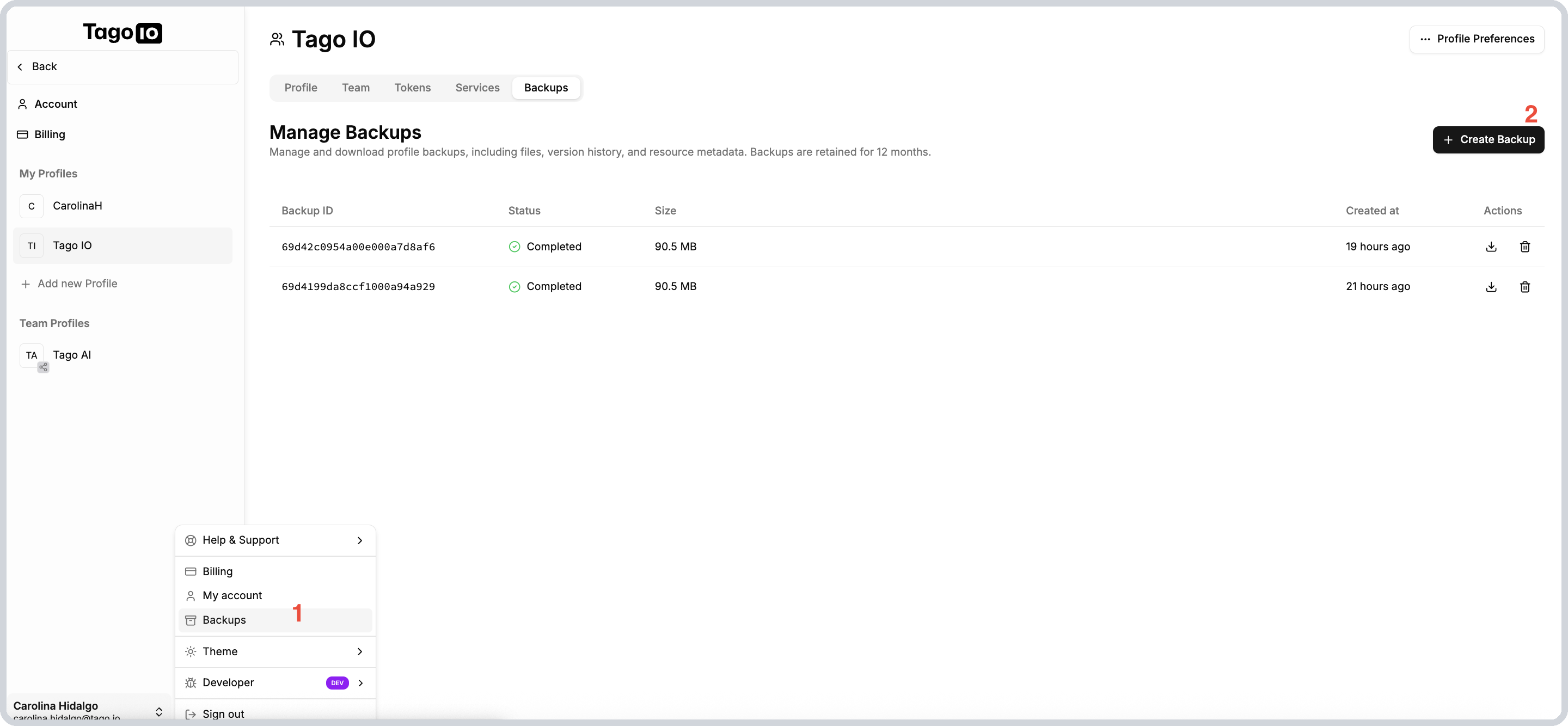

Go to your profile name in the bottom-left corner of the screen and select Backups. You will be taken to the Manage Backups page.
<img src="/img/my-account/backups/manage-backups.png" alt="Manage Backups page" style={{border: '1px solid #d1d5db', borderRadius: '8px'}} />
Creating a Backup​
On the Manage Backups page, click Create Backup. A modal will list all resources included and excluded before you confirm.

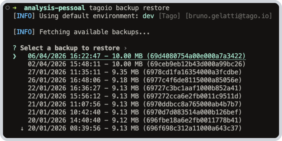

Option 2: TagoIO CLI​
Make sure you have the TagoIO CLI installed and authenticated, then run:
tagoio backup restore
The CLI fetches all available backups and displays them as a selectable list, each entry shows the creation date, file size, and backup ID. Use the arrow keys to pick the one you want to restore.
<img src="/img/my-account/backups/cli-restore-selection.png" alt="CLI backup restore selection" style={{border: '1px solid #d1d5db', borderRadius: '8px'}} />
After selecting a backup, you will be prompted to confirm and authenticate with your resources password, 2FA method, and OTP code. Once authenticated, the CLI downloads and extracts the backup, shows a summary table of all resources and their counts, and asks for a final confirmation before starting the restoration.
