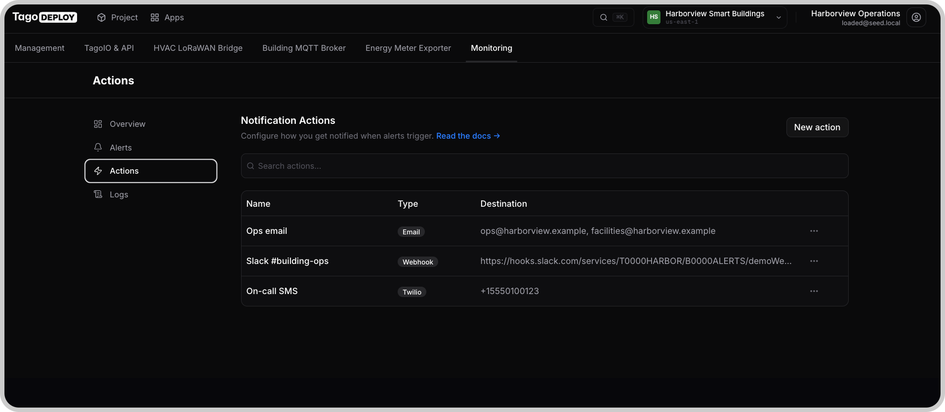

Actions
Actions send email, SMS messages, or HTTP requests when an alert threshold triggers. Actions are reusable, define one and point any number of rules or thresholds at it.
Use the Actions page to create and edit actions. After configuring an action, assign it to an alert rule as a default action or to a specific threshold.
