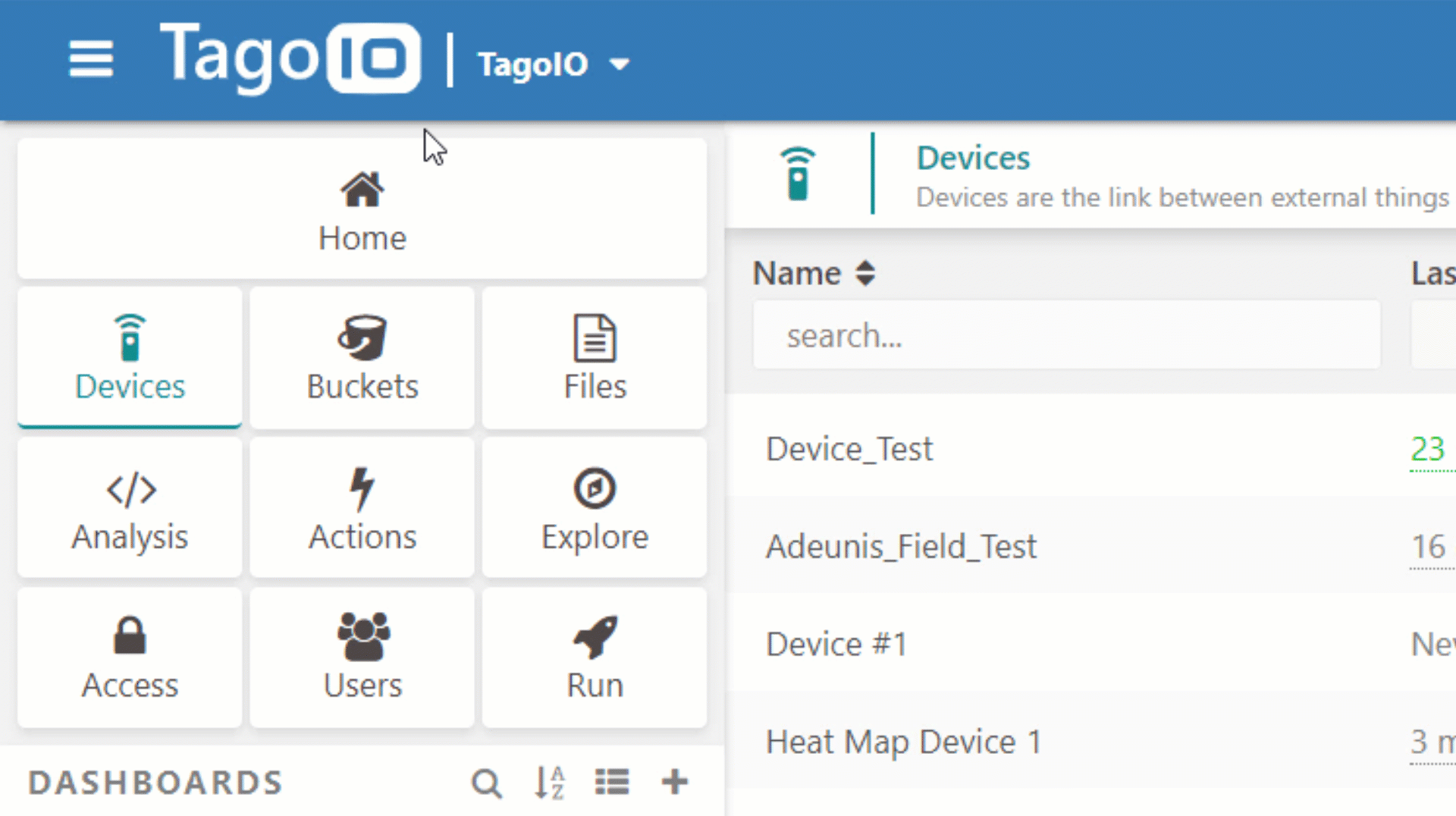

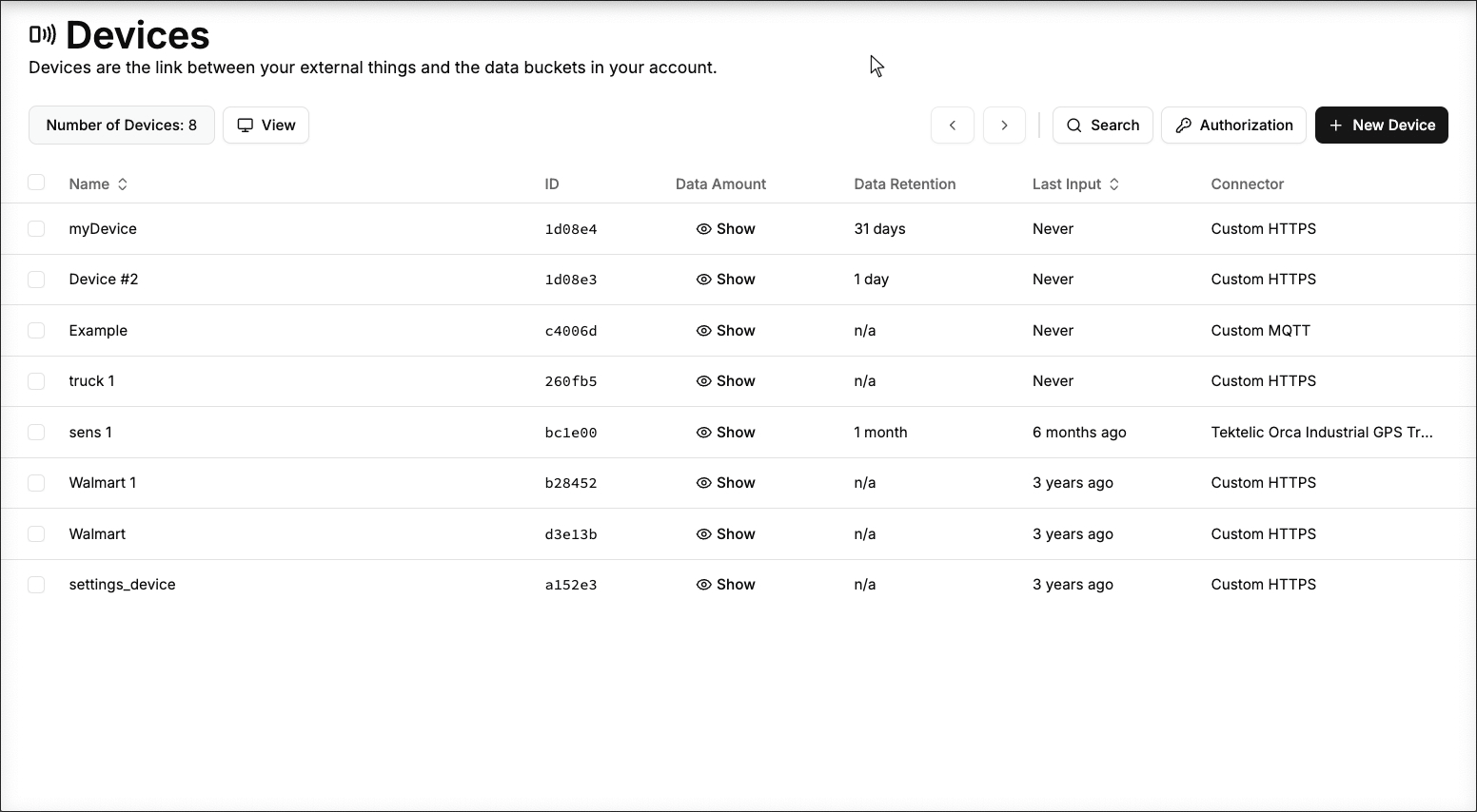

- Click the Device button on the left sidebar.
- Click the Add Device button.
- Look for the type HTTPS and select it.
- In the field "Device Name", add any name for your device.
- Click the Create Device button.

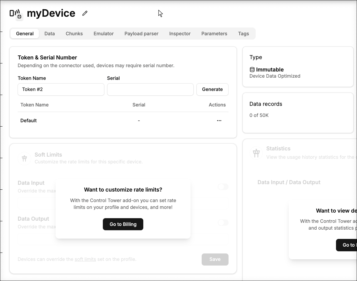

All devices should use a valid device-token when accessing TagoIO. One device‑token is generated when a device is created and it is available for you to copy if you want to insert it in a real device.

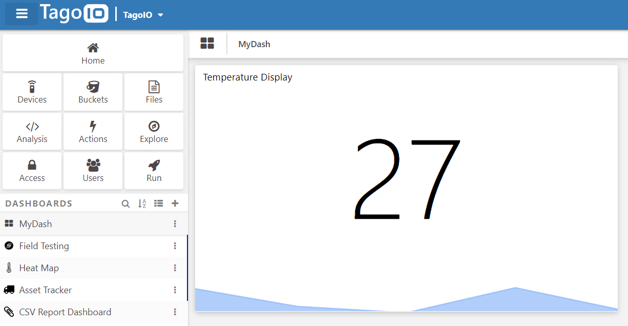

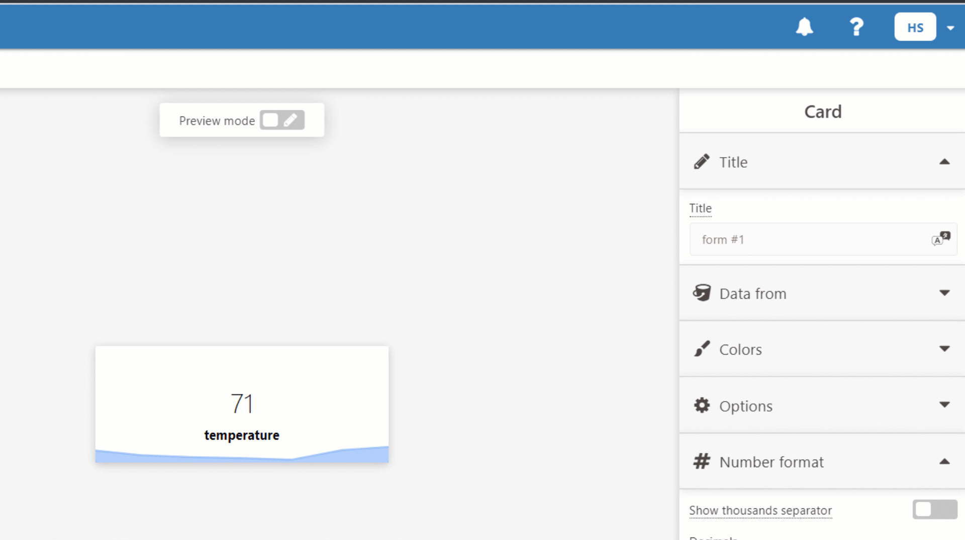

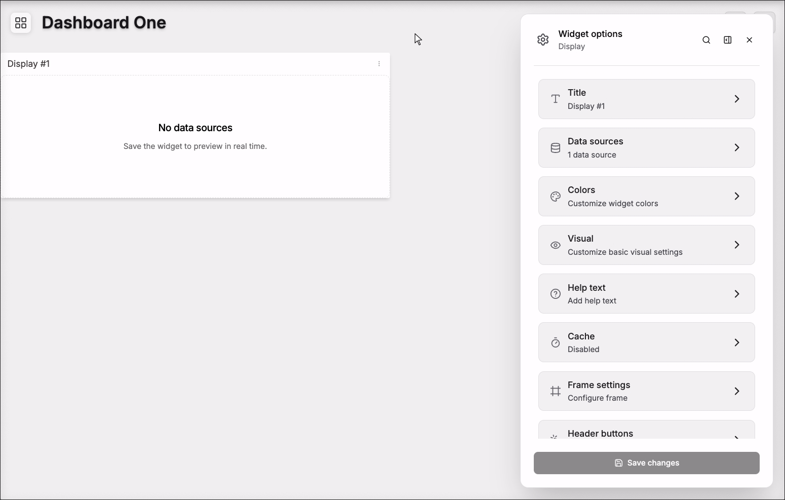

- Add one widget to show the variable temperature. Click + (the top right button), and pick the widget Card.
- Start the configuration of this widget by adding the device and variable to be displayed. Click on the search area then type the variable name that will be sent by the device as temperature, and click Save – your widget will be ready!

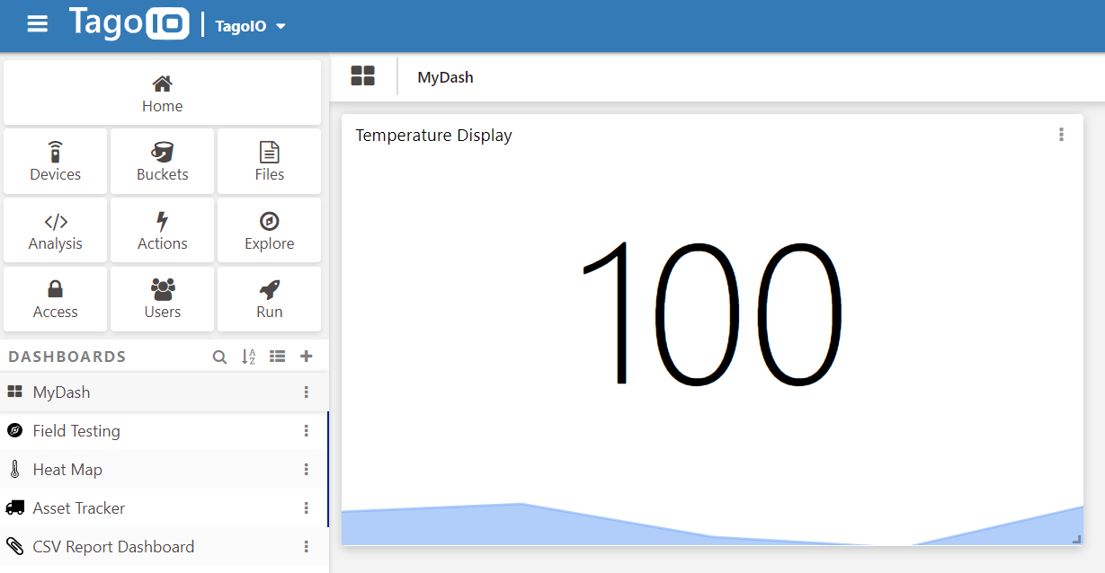

Try to send more data by changing the value of the ‘temperature’. Keep an eye on your dashboard. You should see something like this:

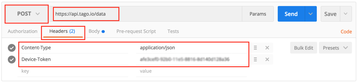

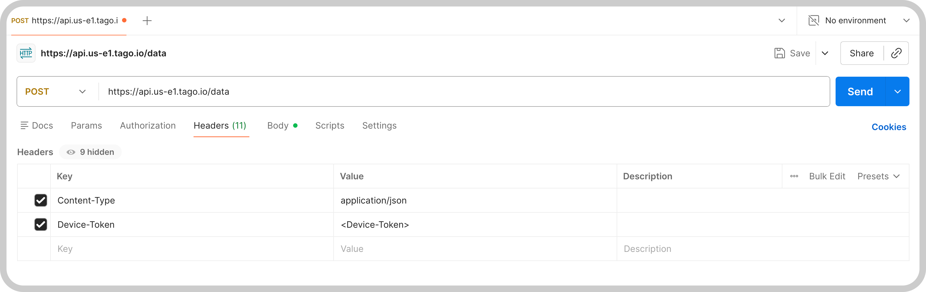

To send data, there are some tools that support HTTP communication like Postman or Insomnia. Considering the same input as used above, you can make a POST by entering the URL, Device-Token, and configuration in Postman like this:

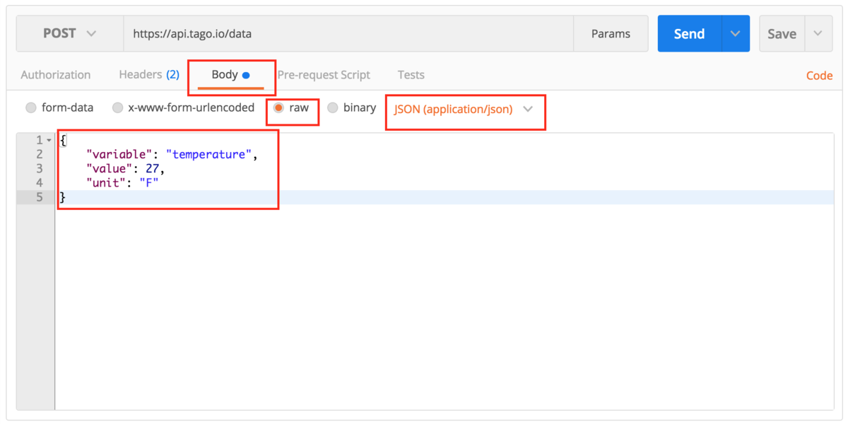

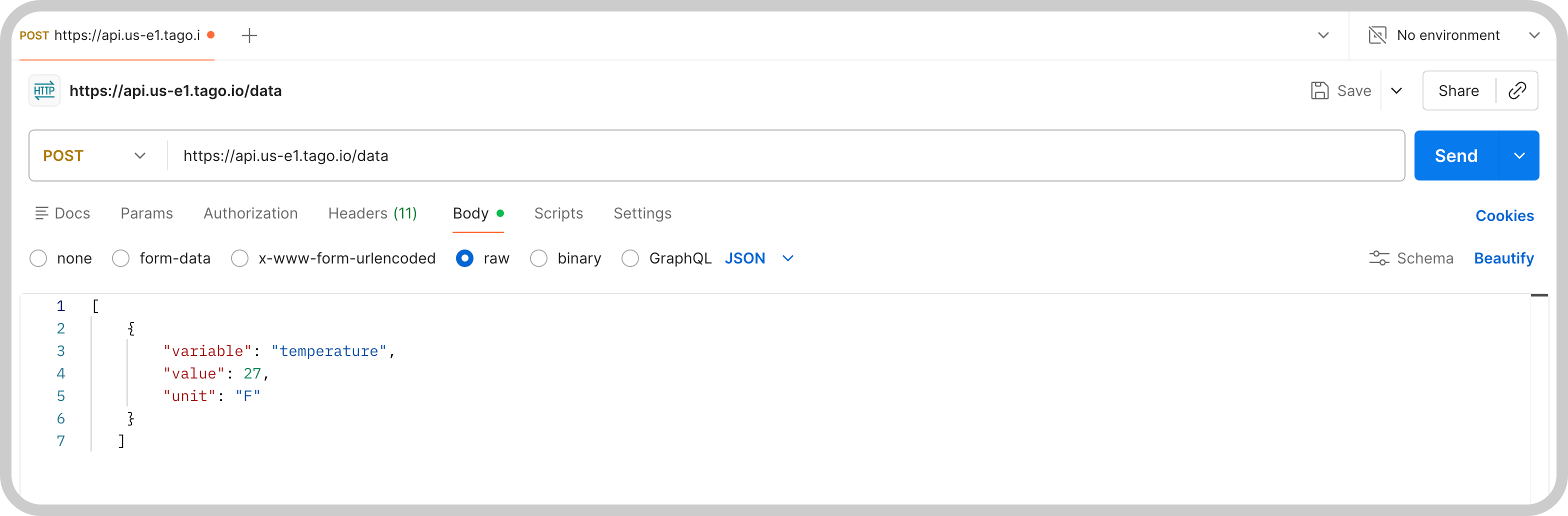

Then, input the variable information in the JSON body. Make sure that you select the same configuration as shown in the picture below.

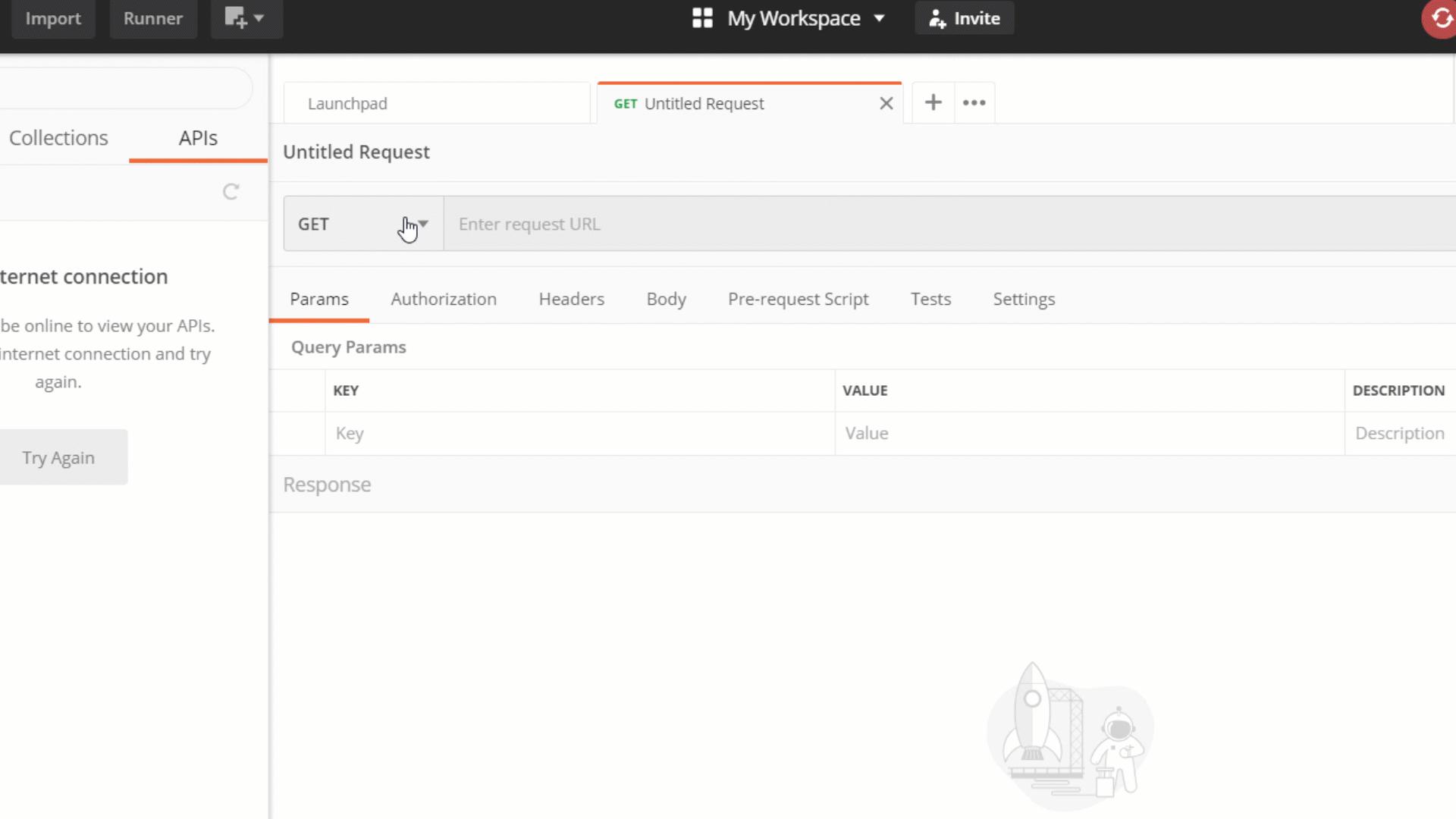

The response should look like this:
